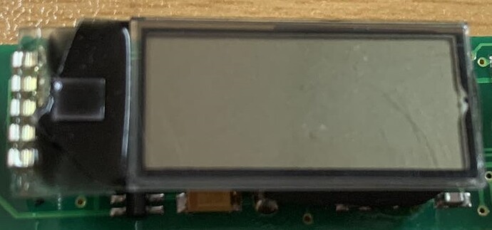

I am trying to look for this kind of LCD but I do not know what it's called. It has five pins.
What do you call this kind of LCD?

Are any of the pins on the display labelled ?
unfortunately, there are no labels on the pins.
Where did you get the display from ?
It is actually from a temperature-humidity usb logger (EasyLog).
It is quite cheap to get custom LCDs made, and select from standard interfaces such as SPI, I2C. So it is quite likely a custom specified LCD, in which case there is no generic type.
Having said that, there are some standard options available e.g.
Hi, I didn’t know you can do this and I don’t think I have this from where I am. But I will try to order the link you shared and see if that LCD will work.
Thank you very much!
Do the chips on the LCD have readable part numbers? If so it may be possible to figure out the interface.
