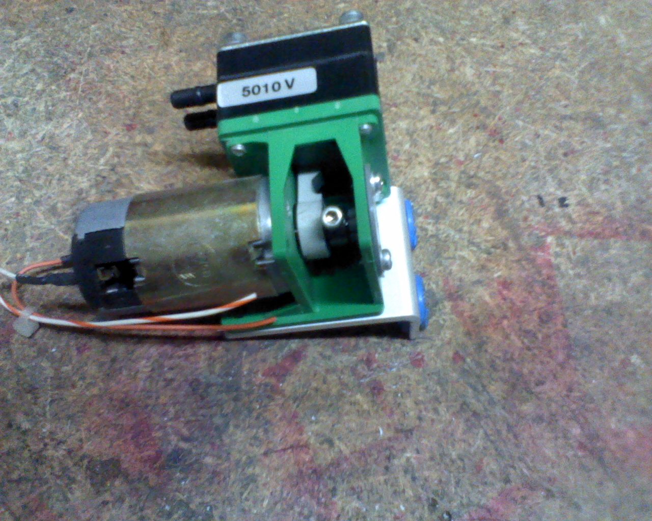

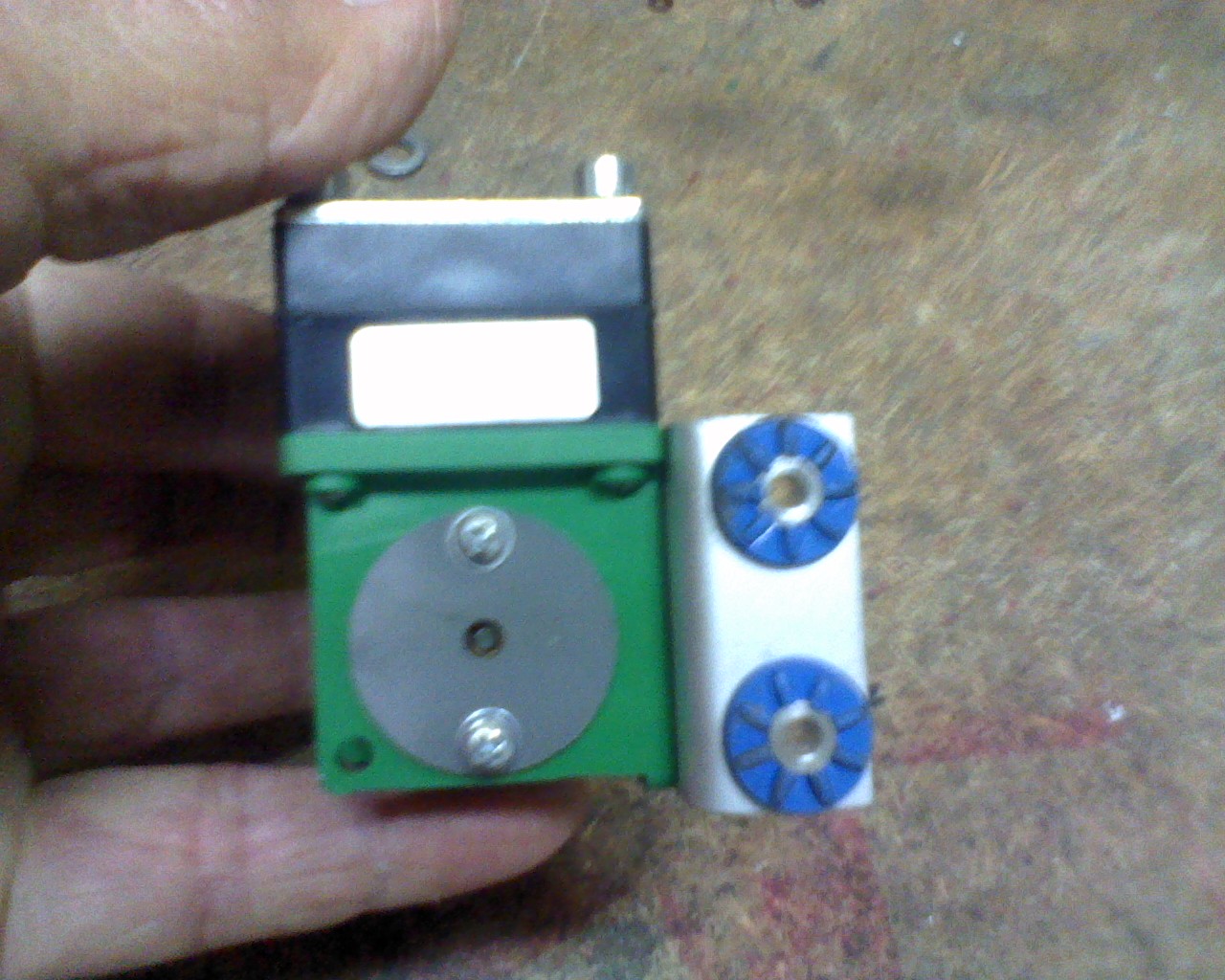

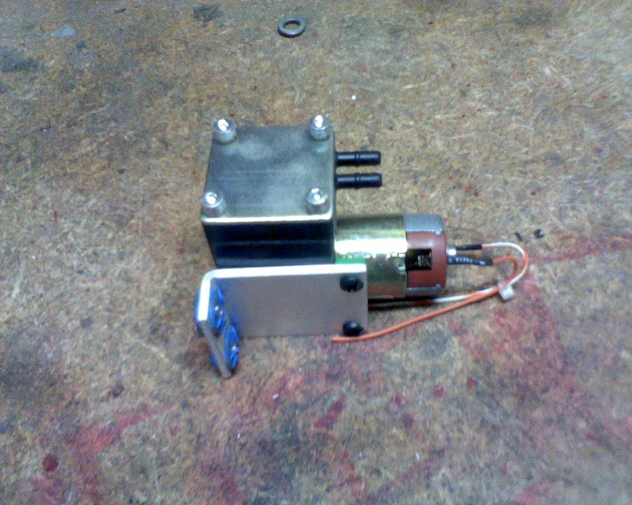

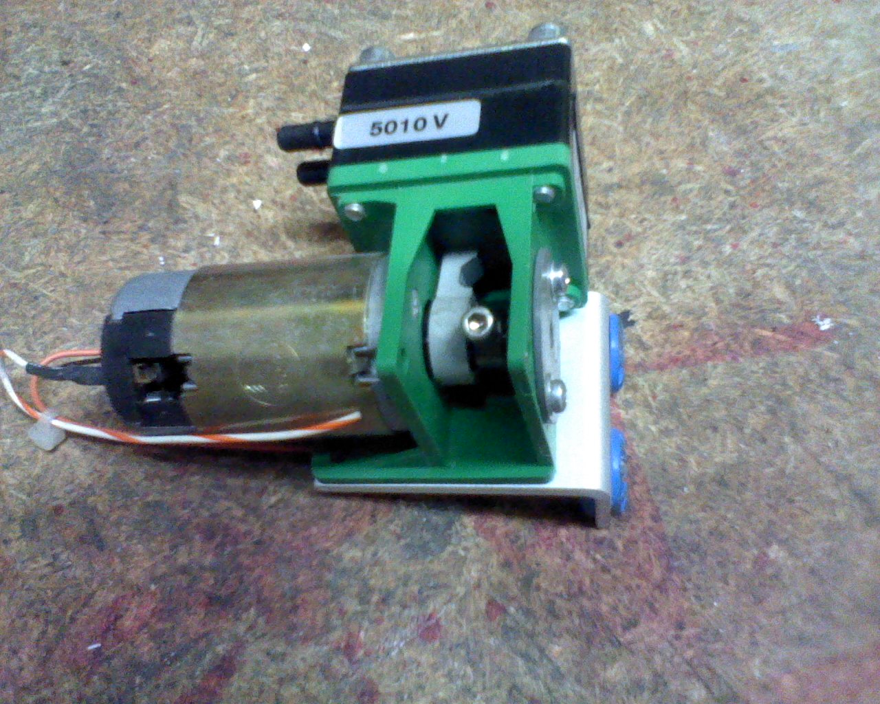

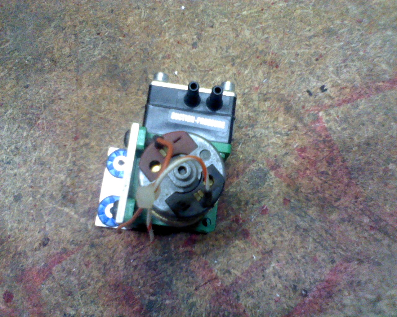

The pump is a diaphragm pump powered by the 12 volt motor. There is no mfg. so the pump was assembled from pieces at the equipment factory. The green frame is plastic injection molded as is the eccentric and connecting arm.

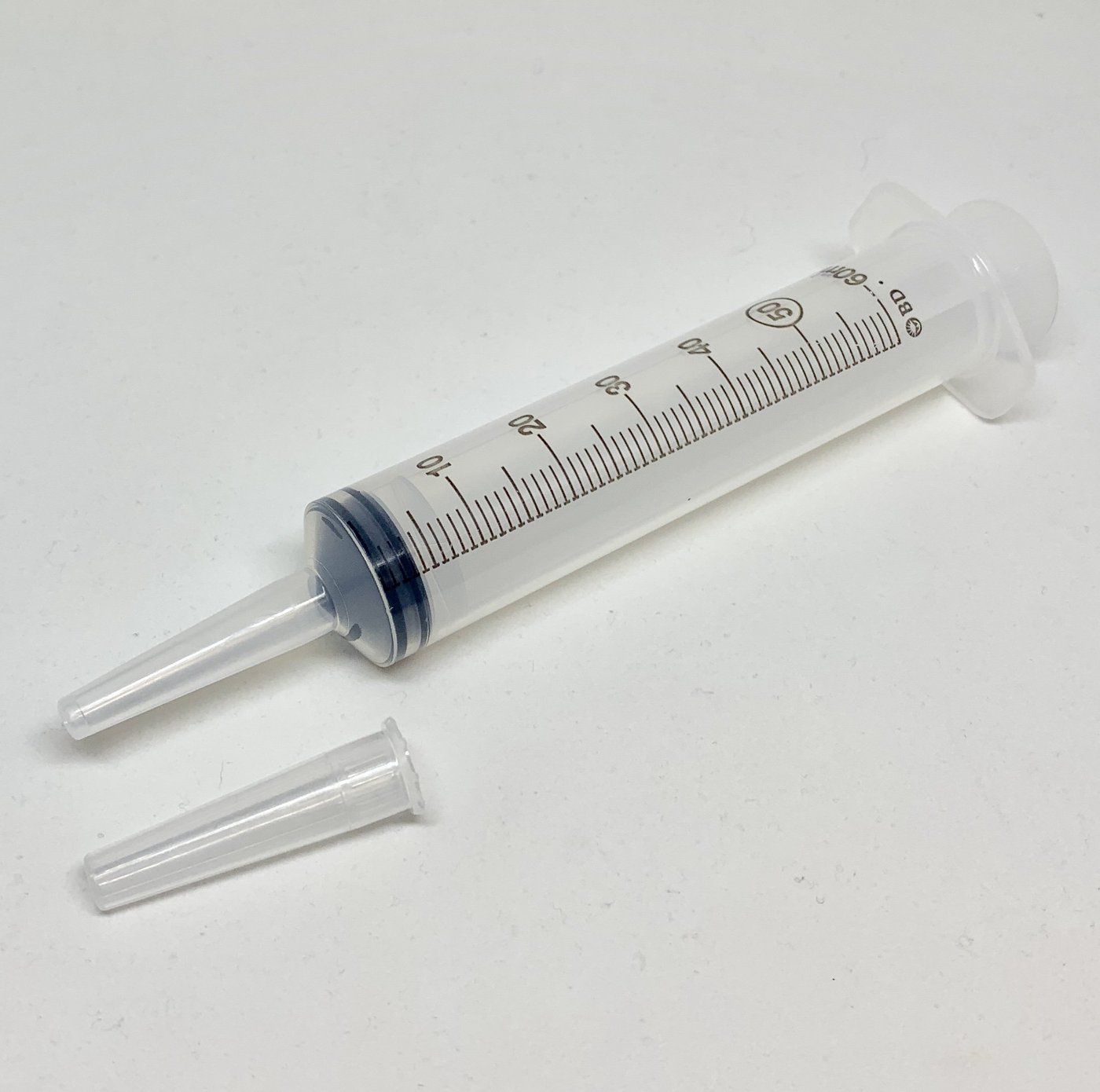

They’re commercially available - search for syringe pump.
Many sizes, and highly evolved technology
I’ve used CAVRO brand in the past.
