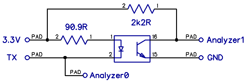

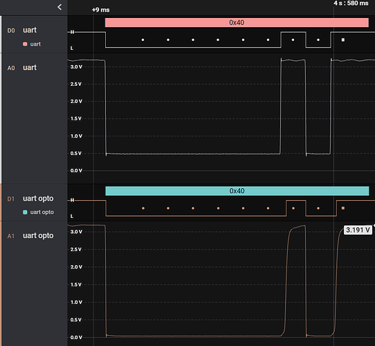

I hooked up an LTV-846 (EDIT: see next post, this schematic is no bueno):
 ![](https://europe1.discourse-cdn.com/arduino/original/4X/7/c/c/7cca4acfe7d1ccc572f9af299f8ad8df5a416252.png)

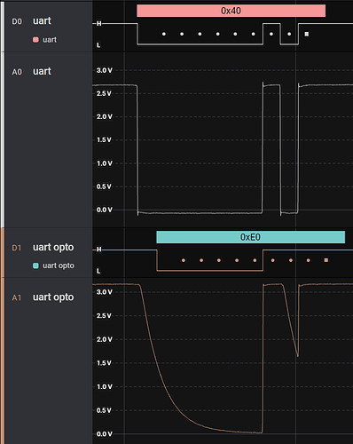

Results at 2400 baud:
 ![](https://europe1.discourse-cdn.com/arduino/original/4X/1/3/0/130b8107f79aa5c8aaf162ce8736a54e55ad352c.png)
D0 and A0 are taken just before the resistor. D1 and A1 are on the other side of the optocoupler. It doesn't look great. D1 did recognize the signal correctly, though the dots aren't nicely centered like they are in D0.

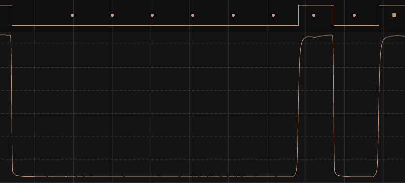

It has errors at 9600 baud, which I'd like to support reliably, if possible:
 ![](https://europe1.discourse-cdn.com/arduino/original/4X/d/c/6/dc6007df454ad10327b3e87cd065fba42d01d0e1.png)

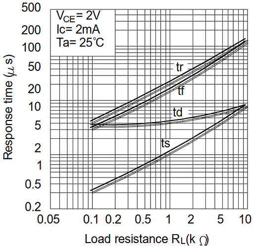

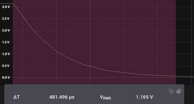

Looks like it's taking 481us for the LED to turn on strongly enough and/or the photoresistor to reduce resistance significantly.
 ![](https://europe1.discourse-cdn.com/arduino/original/4X/a/b/8/ab876b338f0bd75a73e17958cf9ab498a0056fc8.png)

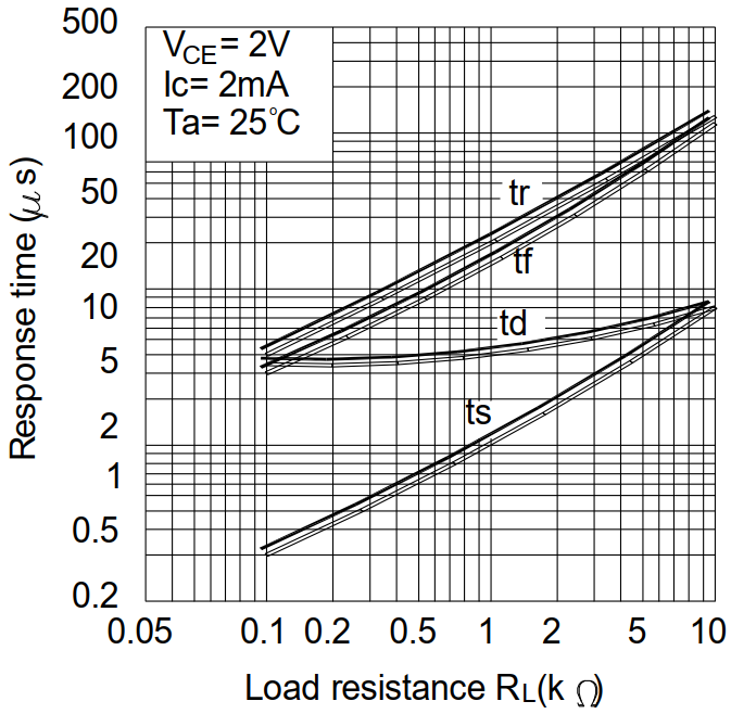

That seems a crazy long time, no? Datasheet says 18us rise/fall time (using other parameters):
![](https://europe1.discourse-cdn.com/arduino/original/4X/7/0/1/701de718e15f2621505ee2922af3fc6b70c2f5bd.png)
 ![](https://europe1.discourse-cdn.com/arduino/original/4X/2/e/3/2e3e7f171e89eab3c6002b7705d7f9f30ee1a7fe.png)
The 3.3V and 90.9ohm resistor with a 1.2V drop for the LED should give 23mA.
Am I doing something wrong? Or is it that this optocoupler isn't suitable for UART?

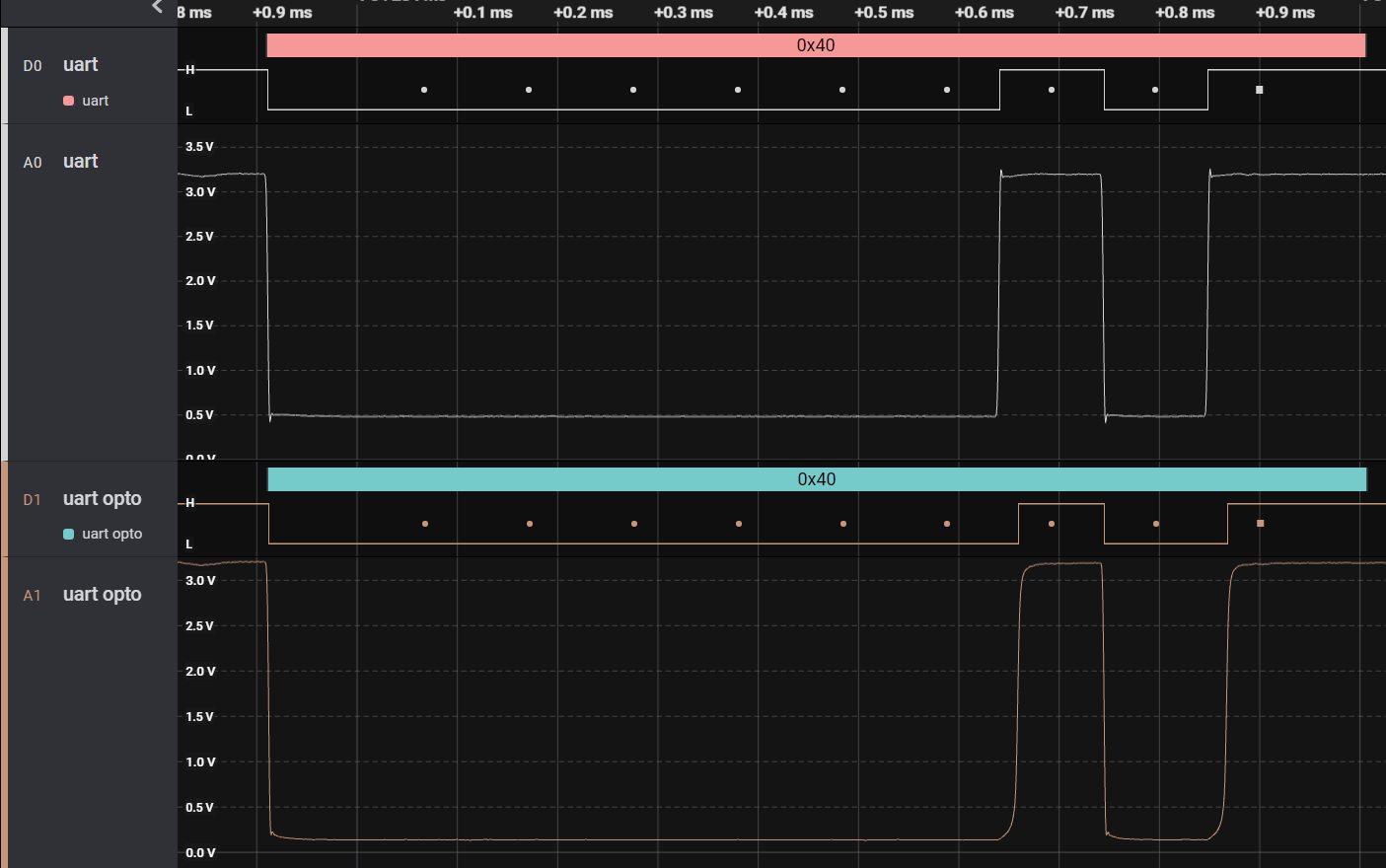

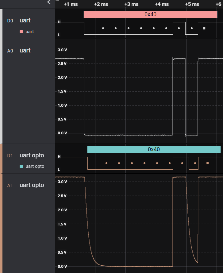

Alright, it works much better like this:
 ![](https://europe1.discourse-cdn.com/arduino/original/4X/8/6/3/863a9836f1b9da8ee9b3fd0464427a19a9f83de0.png)
Here's 9600 baud:
 ![](https://europe1.discourse-cdn.com/arduino/original/4X/f/0/4/f04bbea12ef9cb8bc2d904d06737384bf816623c.png)
The same but 470ohm pull up:
 ![](https://europe1.discourse-cdn.com/arduino/original/4X/d/c/1/dc1e8871b42c4de7b7dfa4b603737983a4d4645b.png)
1K pull up looks pretty OK too. I've also tried decreasing the current through the LED, replacing 90.9 even with 1K still looks OK. That should be ~2.1mA. Maybe 470 is a better choice, 4.47mA.

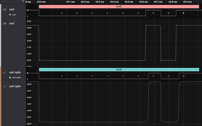

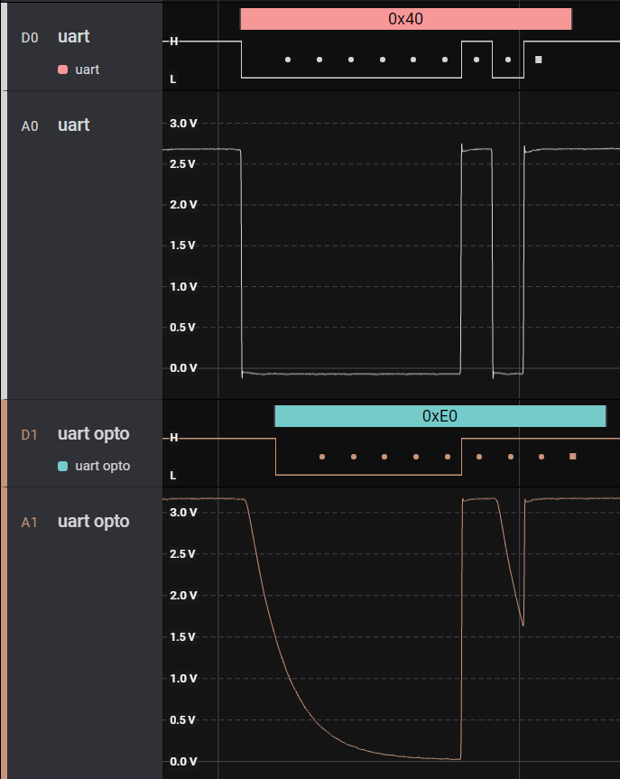

Here's 9600 baud, 1K pull up, 470ohm for the LED (I think this is the one!):
 ![](https://europe1.discourse-cdn.com/arduino/original/4X/c/8/2/c8228478debfa6463ddab9ab56b558d4db232da4.png)
The same at 19200 baud (I'll never go about 9600):
 ![](https://europe1.discourse-cdn.com/arduino/original/4X/6/9/0/690c844713337e6dae2da0ff25a4b08dc6d34588.png)
Fails at 38400:
 ![](https://europe1.discourse-cdn.com/arduino/original/4X/6/e/0/6e0c31b43405fe6796aa2ae6874815d5fb2dd7fa.png)
I think this is the way to go, pending any new feedback from ya'll! I do wonder a bit how differently my ACs might interpret the UART, they might not be as flexible as the logic analyzer. I don't know what a "good enough" UART square wave looks like.
