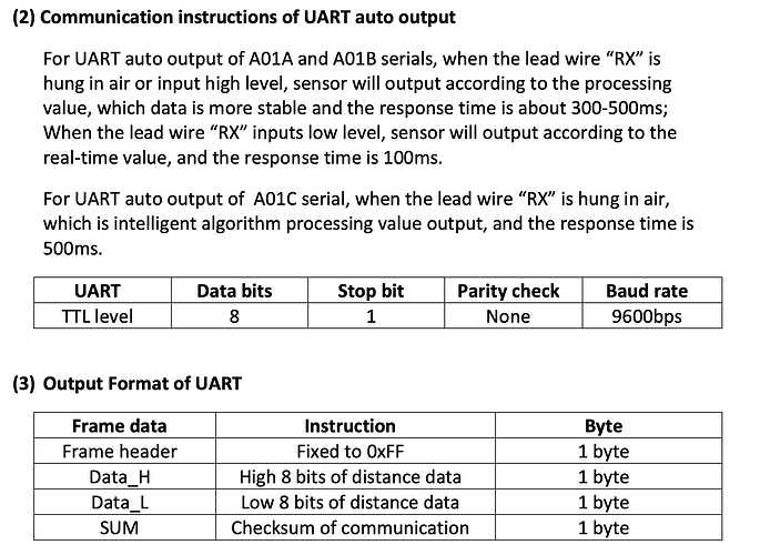

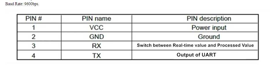

then that would be the important information to deal with
 ![image](https://europe1.discourse-cdn.com/arduino/original/4X/5/1/7/51758a80adad58b5b52d1265d0918bbd00d04b52.png)
OP needs to clarify how the wires have been really connected

These images are in the link I copied above.
![connector_pins](https://europe1.discourse-cdn.com/arduino/original/4X/b/f/4/bf4a9148bf7f2585c7b1cfc49538b7c68d4a9a2f.png)
 ![connector_pins_2](https://europe1.discourse-cdn.com/arduino/original/4X/6/7/6/67621b7d0c50f264a4b314d3c3b66d186d515008.png)
 ![connector_pins_3](https://europe1.discourse-cdn.com/arduino/original/4X/f/1/d/f1dfce8d512e85e4f87a8e1adf667518830a97b3.png)

Thank you for this. I often used the UART auto with this information [https://wiki.dfrobot.com/A01NYUB%20Waterproof%20Ultrasonic%20Sensor%20SKU:%20SEN0313](https://wiki.dfrobot.com/A01NYUB%20Waterproof%20Ultrasonic%20Sensor%20SKU:%20SEN0313)
Now I bought an UART controlled but I can't understand how to read the output.

I had not seen you could get more info
> [@k0ral78](#):
So it seems the frame starts with FF then you have the distance over 2 bytes and then a checksum.
If your wiring is correct my basic sketch at 9600 bauds should spit out the information

**Author:** ![k0ral78](https://avatars.discourse-cdn.com/v4/letter/k/58f4c7/32.png) [@k0ral78](https://forum.arduino.cc/u/k0ral78)\
**Post date:** [January 7, 2024, 5:56pm UTC](https://forum.arduino.cc/t/uart-controlled-ultrasonic-sensor/1208092/13 "2024-01-07T17:56:54Z")
</div>
I think that UART controlled means that there is the need of the trigger to read the output.
In the datasheet posted above i can read:
> When the cable “RX” receives a trigger pulse with falling edge or any serial port
> data, the module makes a measurement, the cable “TX” will output a
> measurement distance value when the measurement is finished every time
Is it enough to trig the output enabling/disabling a digital I/O?

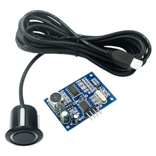

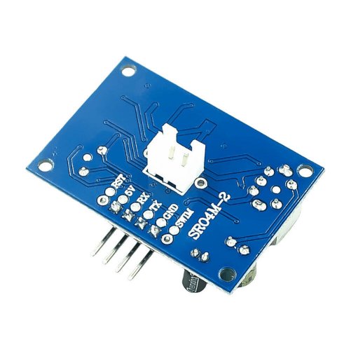

It’s possible that these are 4 different products, in which case I wouldn’t know which one I’m buying, I just have to hope there’s some description within the package to work with.
If it’s one product with several output options, the data in the description on the AliX site is severely lacking on how to set 4 options with 1 input, again just hoping the accompanying paper tells more.
![GL-A19](https://europe1.discourse-cdn.com/arduino/original/4X/c/5/e/c5e8d4b1834b9fdd69eb8d252123bd9313a65306.png)

**Author:** ![stitech](https://dub1.discourse-cdn.com/arduino/user_avatar/forum.arduino.cc/stitech/32/1016377_2.png) [@stitech](https://forum.arduino.cc/u/stitech)\
**Post date:** [January 9, 2024, 7:21am UTC](https://forum.arduino.cc/t/uart-controlled-ultrasonic-sensor/1208092/18 "2024-01-09T07:21:35Z")
</div>
Looking at those pictures, I’m not sure these belong together. The sensor has a USB plug, the board has a 2 pin HY connector. Am I oldfashioned with my idea that a vendor should show what it’s really selling?
Or: do they really sell something from one box with something from another box without questioning if they go together?

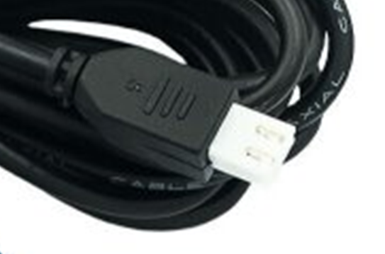

**Author:** ![JohnLincoln](https://avatars.discourse-cdn.com/v4/letter/j/7ba0ec/32.png) [@JohnLincoln](https://forum.arduino.cc/u/JohnLincoln)\
**Post date:** [January 9, 2024, 7:36am UTC](https://forum.arduino.cc/t/uart-controlled-ultrasonic-sensor/1208092/19 "2024-01-09T07:36:47Z")
</div>
> [@stitech](#):
Look more closely, that's not a USB connector it's the mating part for the connector on the rear of the PCB.
![2 pin connector](https://europe1.discourse-cdn.com/arduino/original/4X/b/c/1/bc1a9d9736bbf991ca2acb7676f70207526ef21e.png)
**Post date:** [January 9, 2024, 7:41am UTC](https://forum.arduino.cc/t/uart-controlled-ultrasonic-sensor/1208092/20 "2024-01-09T07:41:07Z")
</div>
I guess you’re right about the connector. It doesn’t help OP with their problem tough, totally different output.
