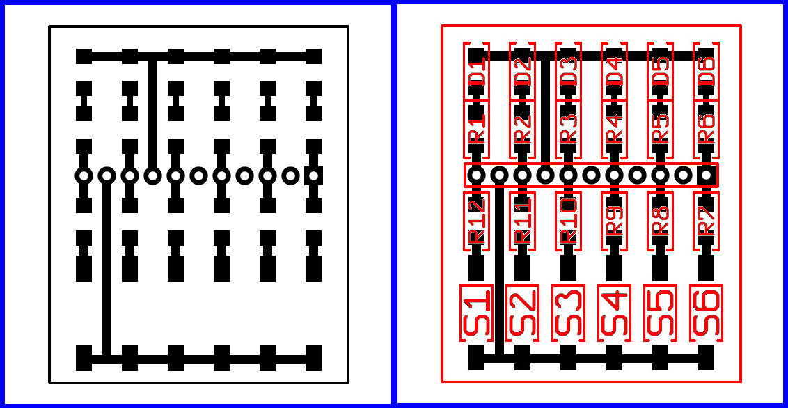

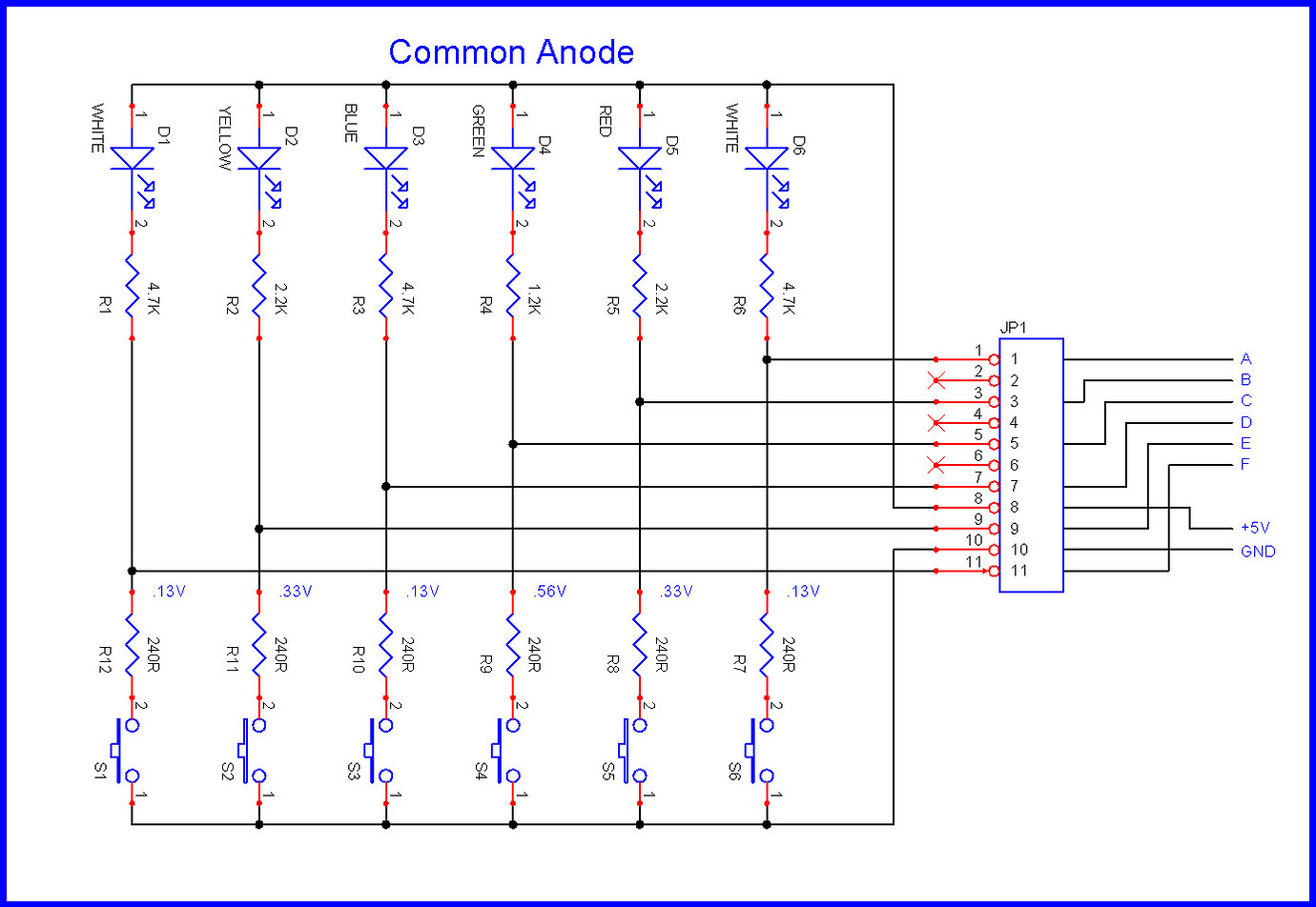

@LarryD are resistors R7-12 necessary? Also why are R1-6 different values? Some of those values seem a little too high for led current limiting.
They probably prevent problems in case the GPIOs are accidentally configured as high outputs.

  • R7-12 are needed when the Arduino a GPIO pin is HIGH (LED OFF).
    If the switch was pressed, pin is made GND, shorting the HIGH 5v to GND. R7-12 limits current.

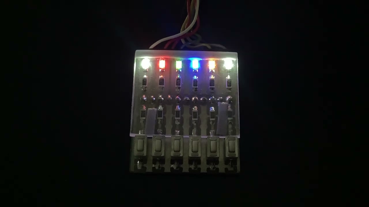

  • I use very HIGH efficiency LEDs, the resistor values are selected so the LED intensity are balanced.
    Blue and white LEDs light if you sneeze on them :wink:
  • If the GPIO pin is output and at a HIGH (LED is OFF), closing the switch does not turn ON the LED.
    When GPIO is made input (to read the switch) and the switch is closed, the LED goes on for the read time, for about 8.6us, every 50ms (very dim).

  • Bought 200 each colour from either eBay or Ali Express a few years back.
    1206 SMD red, green, blue, white, yellow, amber, green.
    I think the site called them Ultra bright :thinking:
PCB
  • The Arduino LED/switch pin is made an output for almost 99.9% of the time, it will be either HIGH or LOW, depending on our code.
  • Let’s assume the pin was output and set to LOW (LED ON).
    Closing/opening the switch at any time will not be a problem.
  • Let’s assume the pin was output and set to HIGH (LED OFF).
    If the switch was open, no problem.
    If the switch was closed, when the output is HIGH, that HIGH is forced to 0v, ouch.
    Our 220R limits the current to 22mA therefore no ouch.
  • Every 50ms (for only 8.6us) we make the GPIO pin input, we read the switch, it could be open or closed; if the switch was closed, the LED goes ON for only 8.6us.

    Let’s say we need LED indicator and we need to monitor a Stop switch; we only have one GPIO available.
  • We wire the LED and switch as shown above.
  • We can now have the LED be on/off under program control and at the same time, monitor our Stop switch.
