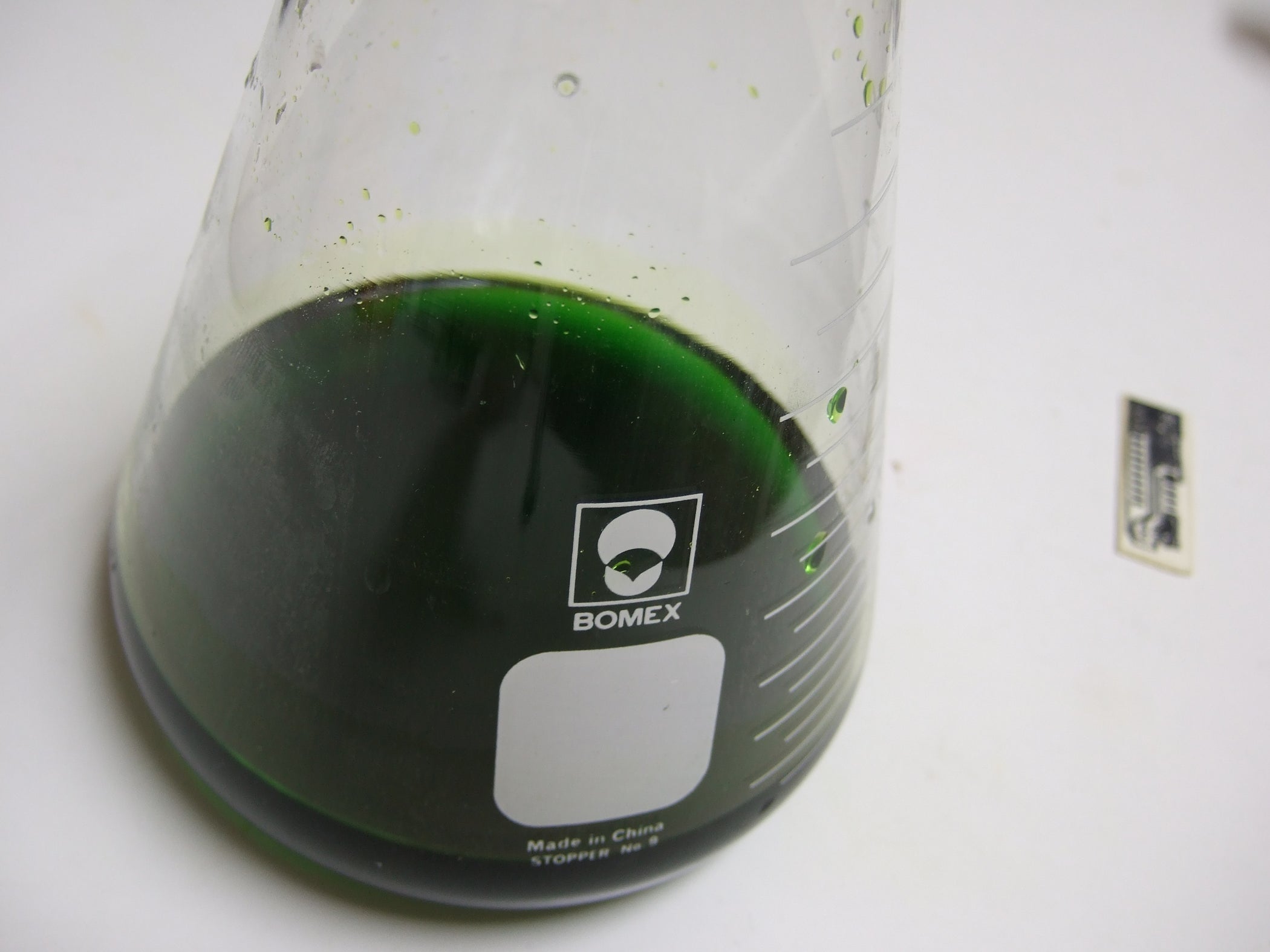

DIY PCBs Are the way to go!
This link will show you how tom make Copper Chloride in Aqueous Hydrochloric Acid Solution! its a reusable CHAEP etching solution
and then all you need to know about How to make PCBs at home
There are a few different methods for etching. The most common one is soaking it in the bath of the etching solution. This tends to waste allot of the solution. Another method is to use a sponge to rub the solution over the board. You still use a plastic container to hold some solution but you don't need as much.
