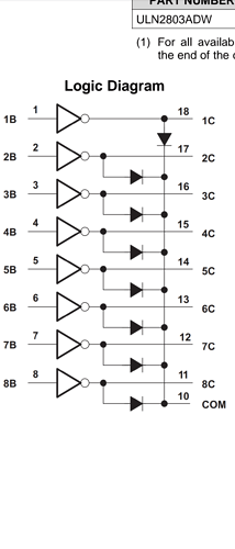

Also, I don't think you want to connect the COM pins of ULN2803 to ground:
Just leave them unconnected.
Connecting COM to ground will make all 8 outputs essentially GND.
Loads will ‘turn ON’.
Example, if there were 8 lamps connected to the outputs, COM going to GND would turn ON all the lamps (lamp test :wink: ).

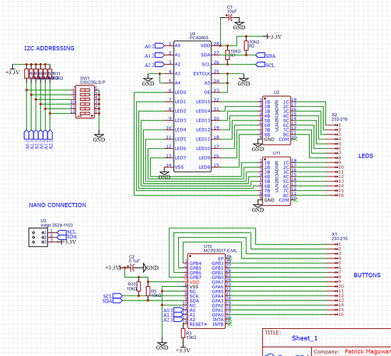

I worked out the part number thanks. What do we think about this:
Im only using 3 addressing pins which will be going to a dip switch. I presume OE goes to ground for arduino. Do you think I need the darlington arrays in this case?
i noticed the vss to gnd missing
Vss needs to connect to GND.
OE is LOW to enable the chip.
You need de-coupling on Vdd.
“ Do you think I need the darlington arrays in this case?”
If you are expecting to handle LED currents, yes.
what type of cap would you use? Considering smd manufactured pcb but the chip is not available so may have to solder this in myself. Trying to make compact.
Ceramic 100nF ( .1 µF ) from the VDD pin to GND.
100nF not 10uF
yeah i posted before i saw your post, changed that :wink:
o.1uF was recommended on the mcp but should i just use the same as the other one?
Also do you think I need both resistors on the SDA SCL lines or would one set be enough for both chips since they are right next to each other?
Remind us what Arduino board you will be using ?
it will be a nano 33 IOT
When two devices share SCL and SDA you only need one set of pullup resistors.
perfect and what do you think of the caps, should they both be the same? I am moving the final pieces on the PCB layout. I have looked up a lot on decoupling caps but it is a minefield
You need one capacitor for each chip; install close to the VDD pin.
should i use the same type of cap for each, I think it is easier for the pcb manufacture if I limit parts
