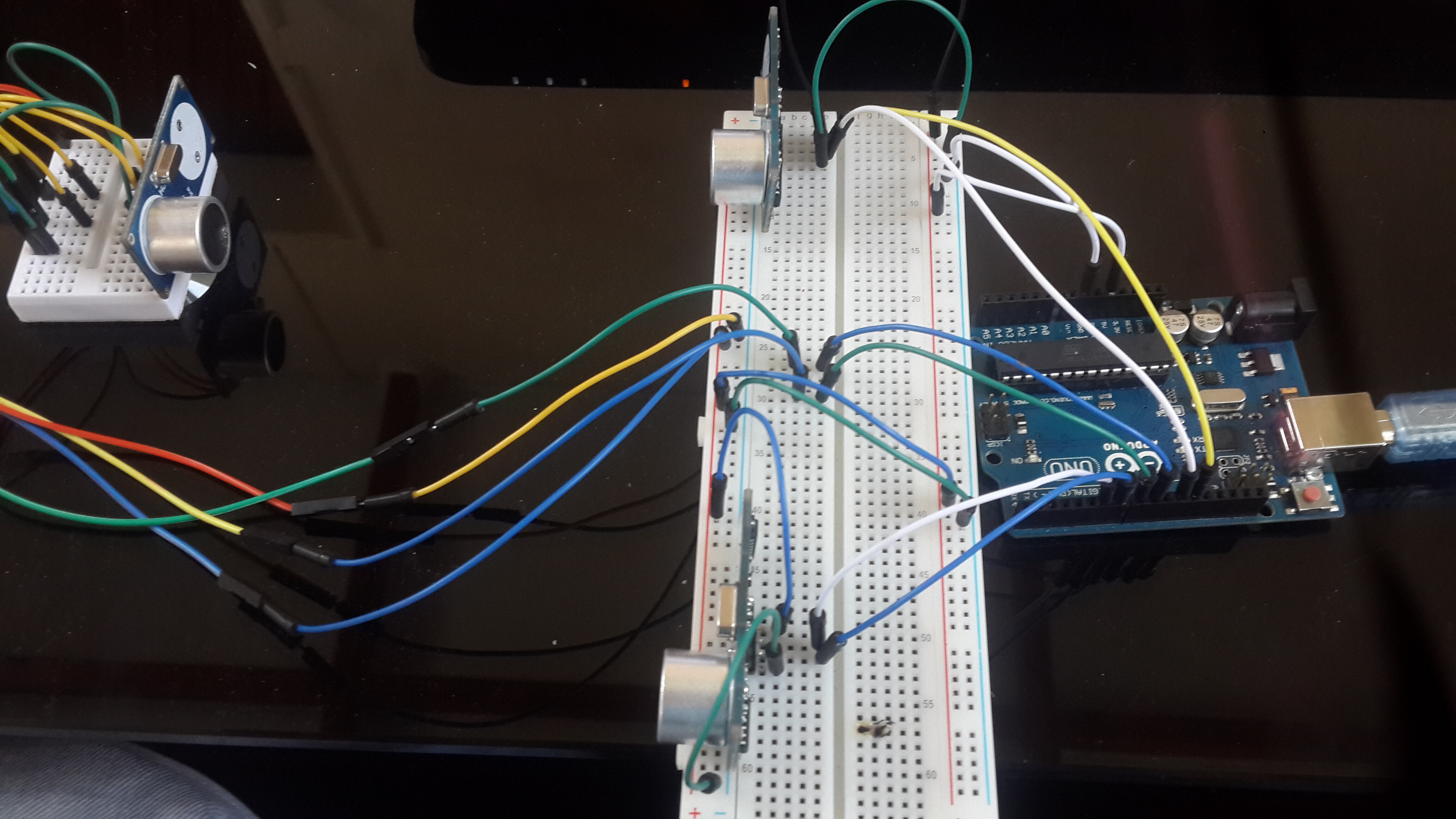

Hi there need some advice, i found this code and i would like to use it for my sensors, but i want to know if it would work so that all my sensors start at the same time but i dont understand the code that well, if you could please tell me first of all if it will work and second what would i need to change in the code?
Thank you

Thank you Dexter, it explains alot, but the sensors are not sending and receiving at the same time are they? i attached a pic of what im doing will it work for that?

He's pointing out than when you want to test equivalence you need to use == not just =.
if (sensor ==1){
oops ??
i use the sensor ,, for counting ,,
you can also put this in series ,, so you wil never read them al at same time ,,
line after line ,,
now it counts sensor .. 1 then reads sensor 1 ,, then go to sensor 2 ,read 2 ,,
or did i doo something wrong ?
oke the counter ,, i found it :sweat_smile:

Dexter ive got three sensors two need to recieve and one only sends signal, so they need to start there cycle at the same time if im correct so that they dont time out or so they are in sync.
if (sensor =2)
Oops again.
 if (sensor =3)
and again . . .
another problem in that:
 int sensor;   // in also for incoming
int sensors ; // counter for sensors
you are using sensor for this counter:
sensor= sensor ++;
and this value...
sensor = incoming2/ US_ROUNDTRIP_CM;  // here it converts the value to cm
change the name of your counter to something like
int counter;
void loop (){
  delay (1000);
  NewPing sonar1(2, 3, MAX_DISTANCE); // sensor pins for incoming sensor 1
  incoming1 = sonar1.ping();  // here it wil ping a signal and recieve
  sensor1 = incoming2/ US_ROUNDTRIP_CM;
  NewPing sonar2(4, 5, MAX_DISTANCE); // sensor pins for incoming sensor 2
  incoming2 = sonar2.ping();  // here it wil ping a signal and recieve
  sensor2 = incoming2/ US_ROUNDTRIP_CM;  // here it converts the value to cm
  NewPing sonar3(6, 7, MAX_DISTANCE); // sensor pins for incoming sensor 3
  incoming3 = sonar3.ping();  // here it wil ping a signal and recieve
  sensor3 = incoming3/ US_ROUNDTRIP_CM;  // here it converts the value to cm
  NewPing sonar4(8, 9, MAX_DISTANCE); // sensor pins for incoming sensor 4
  incoming4 = sonar4.ping();  // here it wil ping a signal and recieve
  sensor4 = incoming4/ US_ROUNDTRIP_CM;  // here it converts the value to cm
This is why arrays and for loops were invented.
it works on my side :drooling_face:
maybe this is not the way you learn it ,, but it works
Undermentioned:
I've got three sensors. Two need to recieve and one only sends signal, so they need to start there cycle at the same time, if I'm correct, so that they don't time out or so they are in sync.
Connect the three Trigger pins together. Remove the senders from the two units that you want to be Receive Only. Trigger all three by pulsing the Trigger pins. Connect the two Echo pins to two digital input pins and alternate between reading the two inputs.
If you bought units that have a combined Trigger and Echo pin, spend $6 to get three of the the HC-SR04 model:
http://www.fasttech.com/product/1012007
ok you want one transducer to transmit a beacon ,, others to read ,,
i tryed this method once ,,
you can do as above ,, but you stil use 4 x a input ,, if you want diverisity ,,
my english is not super ,, so i hope you understand ,,
you have to keep in mind that you wil have milis seconds delay ,, these delays are also measured

but i think when you use the echo pin it wil start calculating when it got asked for it ,
so this wil also delay ,, the beacon

Take a look at how much more simple your code can be if you used arrays and for loops:
(untested)
#include <NewPing.h>
#define MAX_DISTANCE 500
int counter;
int sensorPins [4] [2] = {{2,3},{4,5},{6,7},{8,9}};
int incoming [4];
int myRead;
void loop ()
  delay (1000);
  Serial.println (counter);
  counter++;
  if (counter > 3) counter = 0;
  incoming [counter] = updateDistance(sensorPins[counter][1], sensorPins[counter][2]);
  Serial.print ("cm =");
  Serial.println (incoming [counter]);
  Serial.print ("sensor digital reading value incoming ");// prints out the reading value in cm
  Serial.println (myRead);
  if (counter = 3)
    for (int i = 0; i < 4; i++)
      Serial.print(F("sensor digital reading value incoming "));
      Serial.print(i);
      Serial.print(F("  "));
      Serial.println(incoming[i]);
      Serial.print(F("all outputs  "));
int updateDistance(int pin1, int pin2)
  NewPing sonar(pin1, pin2, MAX_DISTANCE);
  myRead = sonar.ping();
  int myValue = myRead / US_ROUNDTRIP_CM;
  return myValue;
