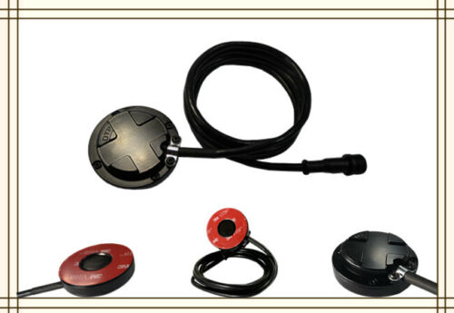

The sensor mentioned in this thread can measure the height of a fluid in a metal tank when it (the sensor) is glued to the bottom of the tank: How to read serial data from Non-contact Ultrasonic liquid level sensor - Sensors - Arduino Forum
You could try it to see if it works with your plastic tank.
It would need to be calibrated for your fluid.

There seems to be dedicated sensors for this application
