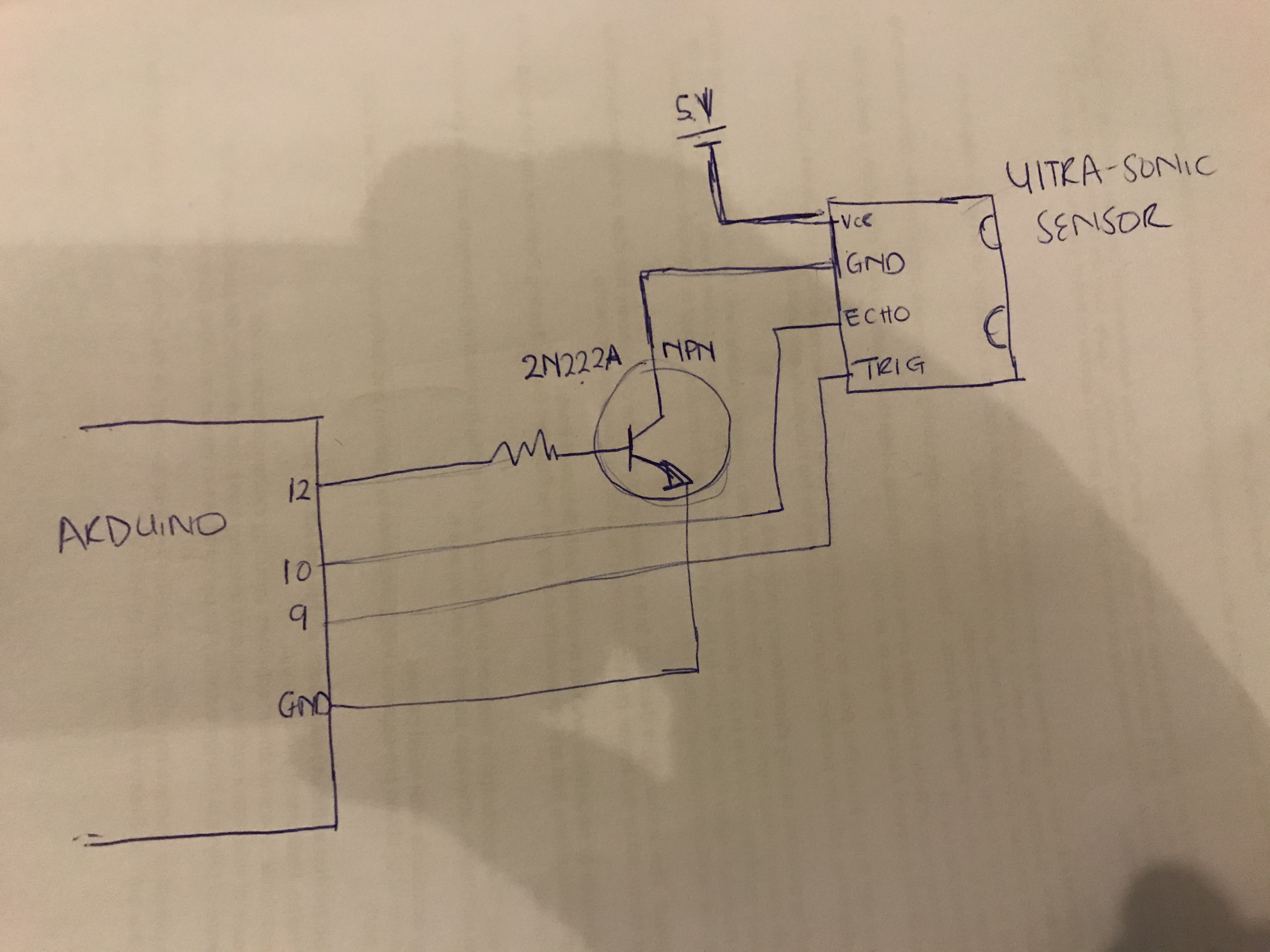

I have an ultrasonic sensor (JSN-SR04T) connected to an Arduino. In order to achieve low power consumption i decided that i want to switch the Ultrasonic sensor off for 8 seconds intervals in between , I connected the sensor via a transistor and used a signal from the Arduino to the npn base to control the switching (ON/OFF) of the transistor.
My problem is that the sensor remains on even when i switch of the signal to transistor base. Does anyone know how to solve this. I suspect that the sensor finds its way to ground even somehow
may be go for a High Side transistor switch (PNP BJT or P-Channel MOSFET) and cut the 5V supply
alternatively, if it is a common HC-SR04, it only draws about 6/8 mA so you can power it from a digital output pin that you would put to LOW when you want to turn it off.

when off: set trig/echo as input pins. Then this should work.
(else parasitic currents is powering the unit)

The HC_SR04 draw so little power that you can power it directly from an Arduino pin. That's what I do because it lets me plug the four pins into four consecutive Arduino pins. Set the Vcc pin to OUTPUT, HIGH and the GND pin to OUTPUT, LOW to turn it on.

Move power in directly to 5V-pin (not Vin)
Iv connected power directly to the VCC pin of the Atmega328, I have built a bare minimum arduino as a way to save more power
