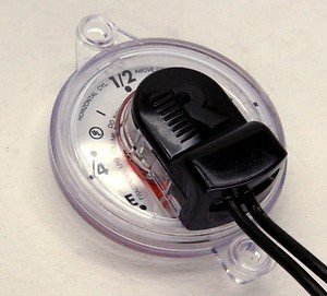

May I suggest you think about inventing some device to set on the current tank gauge and occasionally look at the needle and report that to your inside unit. What that device might look like and how it would operate is a mystery. Perhaps, if the needle is black, use a light reflection from the background to find a spot where the reflection was obscured by the needle.
Paul
There's this which is apparently a 100 ohm pot linked to the rotating needle...
Hmmm... LED illumination and multiple photoresistors going to a resistor ladder?? Don't need any resolution above 1/2 tank or so...
Interesting device.
