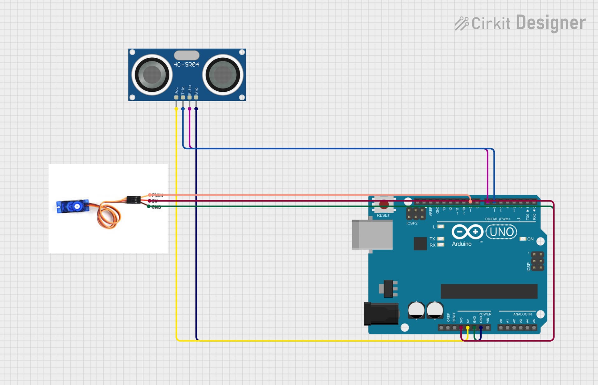

![circuit_image](https://europe1.discourse-cdn.com/arduino/original/4X/0/e/8/0e88f69a7690a16b5d1a163b339d586e661fb7a5.jpeg)
it does not move when detected. although it moved back then

Have you written code and uploaded it to Uno?

yes
```arduino
SERVO VIA ULTRASONIC
#include <Servo.h>
// constants won't change
const int TRIG_PIN = 9; // Arduino pin connected to Ultrasonic Sensor's TRIG pin
const int ECHO_PIN = 10; // Arduino pin connected to Ultrasonic Sensor's ECHO pin
const int SERVO_PIN = 5; // Arduino pin connected to Servo Motor's pin
const int DISTANCE_THRESHOLD = 10; // centimeters
Servo servo; // create servo object to control a servo
// variables will change:
float duration_us, distance_cm;
  Serial.begin (9600); // initialize serial port
  pinMode(TRIG_PIN, OUTPUT); // set arduino pin to output mode
  pinMode(ECHO_PIN, INPUT); // set arduino pin to input mode
  pinMode(13, OUTPUT); // set arduino pin to input mode
  servo.attach(SERVO_PIN); // attaches the servo on pin 5 to the servo object
  servo.write(0);
  // generate 10-microsecond pulse to TRIG pin
  digitalWrite(TRIG_PIN, HIGH);
  digitalWrite(13, HIGH);
  delayMicroseconds(10);
  digitalWrite(TRIG_PIN, LOW);
  // measure duration of pulse from ECHO pin
  duration_us = pulseIn(ECHO_PIN, HIGH);
  // calculate the distance
  distance_cm = 0.017 * duration_us;
  if (distance_cm < DISTANCE_THRESHOLD)
    servo.write(180); // rotate servo motor to 90 degree
    servo.write(0); // rotate servo motor to 0 degree
  // print the value to Serial Monitor
  Serial.print("distance: ");
  Serial.print(distance_cm);
  Serial.println(" cm");

Try this:
```arduino
//SERVO VIA ULTRASONIC
#include <Servo.h>
unsigned long duration_us;
float distance_cm;
  digitalWrite(TRIG_PIN, LOW); // set LOW
  //pinMode(13, OUTPUT); // set arduino pin to output
  servo.write(0);
  //digitalWrite(13, HIGH);
  distance_cm = 0.0172 * (float) duration_us;
  // if distance is less then DISTANCE_THRESHOLD move to 90 degrees
  // else set to 0 degrees
    servo.write(90); // rotate servo motor to 90 degree
