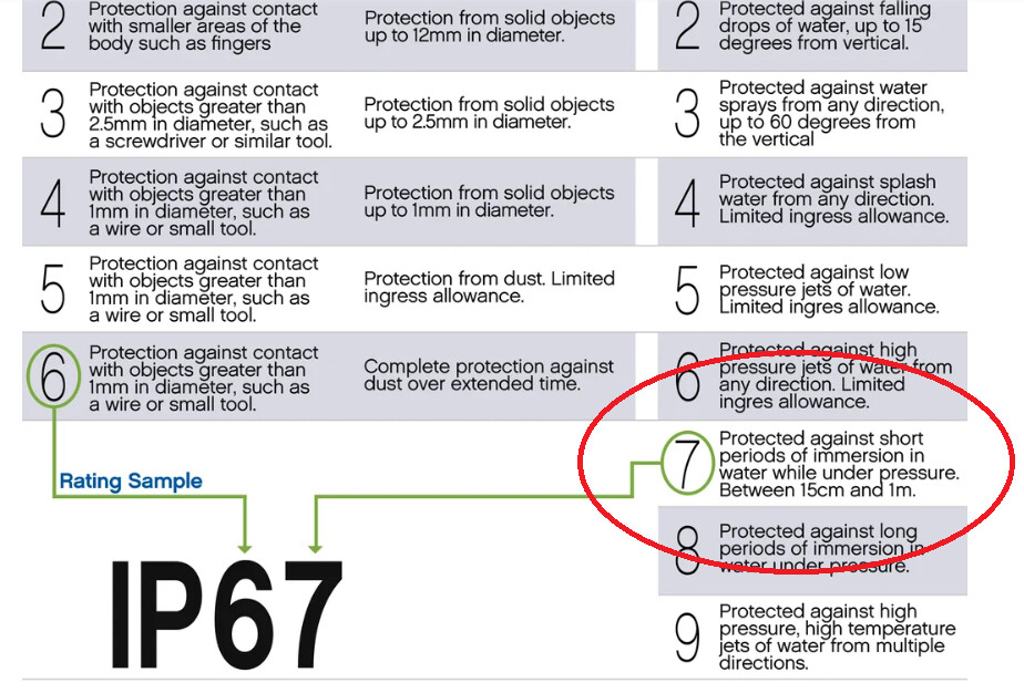

@jremington Reading the link you posted I understood that it works ONLY underwater.
I would like to use it on top of a water tank to measure the water level. Therefore it's not useful to me. I would like to have IP68 because the other DFRobot sensor IP67 in the same scenario (on top of water tank) stops working after few months. I thought it was because of water infiltration.
This is the link of the other
IP67 sensor
No surprises there. Any powered electronics operating in a moist environment will eventually corrode due to condensation and electrolysis on the PCB, no matter how well is is protected against water intrusion. For operation inside a tank, at 100% humidity, it needs to be completely encapsulated or "potted" in silicon compound, as done for underwater use. Check the Maxbotix site for their recommendations.
A much better approach to monitor water tank level is to use a liquid pressure sensor, mounted at the bottom of the tank, or in the outlet pipe. If the latter, expect spurious readings when water is flowing due to the Bernoulli effect. I've been doing that for over 10 years, with only one sensor failure.
You can also buy absolute tank pressure sensors that are intended to be permanently submerged on the tank bottom, and don't suffer from the Bernoulli effect.

If placed at the bottom of the tank pointing up, the underwater sensor should read out the distance to the water surface. The water surface very effectively reflects sound -- as well as any solid object.
@TomGeorge i didn't put the IP67 sensor underwater, but on top of the tank under the cover. There is no water there but there is humidity for sure.
