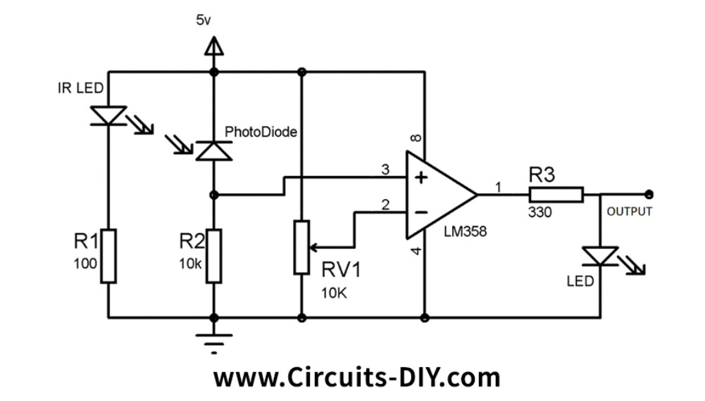

This code works well up to around 16000 RPM and then it breaks . After a bit of playing around I found that the elapsed variable (time between two consecutive detection signals from the optical sensor) isn't able to go below 3500-3600 microseconds. This roughly translates to 16,500-17,000 RPM. Here's the code:

Perhaps you are overrunning the frequency response of your optical sensor module. Have you looked at it on your scope to ensure you're getting a clean signal? The other thing that makes me go "Hmmm" is the baud rate you are using. Perhaps 9600 baud is not getting the data printed fast enough to catch the next pulse correctly.
I would also significantly minimize the print requests and definitely not use 9600 bauds which might let the data accumulate in the outgoing buffer and transform print in a blocking call

Can you post a circuit diagram of your project?
A hand drawn image will be fine, please include ALL power supplies, component names and pin labels.
A couple of images of your project would also help.

Everyone, I was finally able to read 20k RPM. The changes are:
Baud rate set to 57,600 (earlier 9600)
detachInterrupt() invoked while transmitting RPM value through serial
@J-M-L@ggutshal@PaulRB your replies have been of great help. Improvements are definitely required in terms of smoothing the output, and I think that's where the suggestions from @JohnRob@Rupert909 should work.
