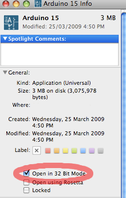

I always get this error method when trying to run Arduino:
Uncaught exeption in main mehod:
java.lang.UnsatisfiedLinkError: /Applications/arduino-0015/Arduino 15.app/Contents/Resources/java/librxtxSerial.jnilib

Ok. Found the screenshot and fixed it by switching to 32 Bit Mode.
:wink:
What did you switch to 32 bit mode?
Probably the flag on the Arduino.app that you can set when you do a "Show info" on it.
Further detail here..
--Phil.
