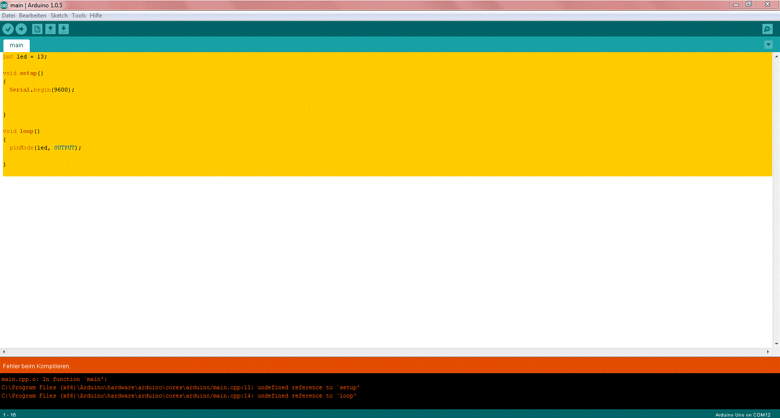

I have a problem with programming my Arduino UNO.
If I write any code, for instance
int led = 13;
  pinMode(led, OUTPUT);
just to try and then upload it, following errors appear:
main.cpp.o: In function main': C:\Program Files (x86)\Arduino\hardware\arduino\cores\arduino/main.cpp:11: undefined reference to setup'
C:\Program Files (x86)\Arduino\hardware\arduino\cores\arduino/main.cpp:14: undefined reference to `loop'
I've tried the example projects already and they work! But if I copy the example code into my test-project and then upload it, the same errors are appearing...
Please help me :wink:
Yours faithfully
Stefan

Hello robtillaart!
Thank you for your reply, I've done this already - nothing got better. =(
I'm using Arduino 1.0.5 for Windows 7.
Do you think it minds where the project is saved?
Otherwise I couldn't explain this strange error...
Is your sketch named "main" (as in main.ino)? It is an obvious name but will create problems. If so, change the name.
