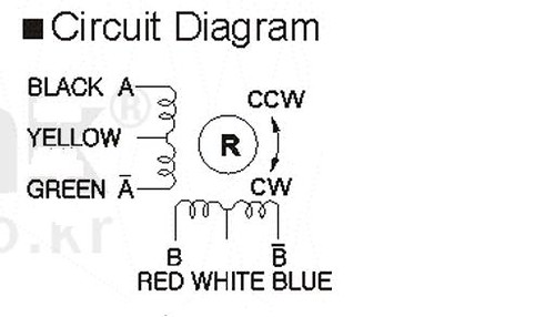

I once arranged a stepper circuit using two ULN2003 chips to cope with the above stepper motor before. The arranement is this.
Imgur
The circuit diagram of the stepper motor is this.
Imgur
Could you advise me where and how can I put a potentiameter?

You have :-
-Current:0.95A/Phase
you can't get that much current with a ULN2003 chip. You will need a FET driver at least. You still have to put current through the coils in both directions with a stepper even if you don't want the motor to turn in both directions therefore you need a H bridge type circuit.
Also:-
int potentiameter = 5;
So you should wire the pot, middle wiper to Analogue input 5, and the two outer connections to +5V and ground. However you don't appear to do anything with the reading in the sketch. You need to use this value to set the speed of the stepping motor. Look at the examples in the stepping library to see how to do this.
Also look at Arduino Playground - InterfacingWithHardware for stepping motor hints.
