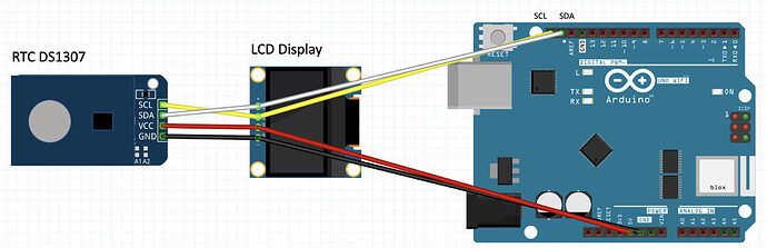

I am connecting two I2C devices in my Arduino UNO Rev2 Wifi
Connected separately they are working fine but when I connect the two at the same time I am getting unknown error in the clock Address.
The clock is working fine once connected alone or with other I2C devices
Here is the output of the port scanning (i2c_scanner):
22:46:33.275 -> Scanning...
22:46:33.275 -> I2C device found at address 0x3C !
22:46:33.313 -> I2C device found at address 0x60 !
22:46:33.385 -> Unknown error at address 0x68
22:46:33.385 -> done
0x3C is the LCD screen, 0x68 the clock

Adding resistors just in case tells me you did not check out what you have. What value were they, you know the schematic shows 4.7K already on the board. What are the I2C limits? I suspect the other boards have them as well. Links to each hardware device showing technical details helps. Your link to Grove was not much technical help. Research the details of each part and post a schematic, not a frizzy thing. How long are the I2C lines?

You state: Regarding technical details, the setup is very simple." as we are finding it is not as simple as it appears. Yes post the Schematic, not a frizzy thing. Are the grounds of each item connected together? Do you have any test equipment available? Be sure all the I2C selects on the hardware items are sound. If you have a spare part try it and see if the problems change.
Since connecting groove modules is pretty straight forward, the problem is not the circuit. Post it anyway to rule out any doubts.

This is the basic schema, as giorgio says is straight forward. I am using the Grove base and standard cables. Also tried without the grove base (like in the schematics) with same results
