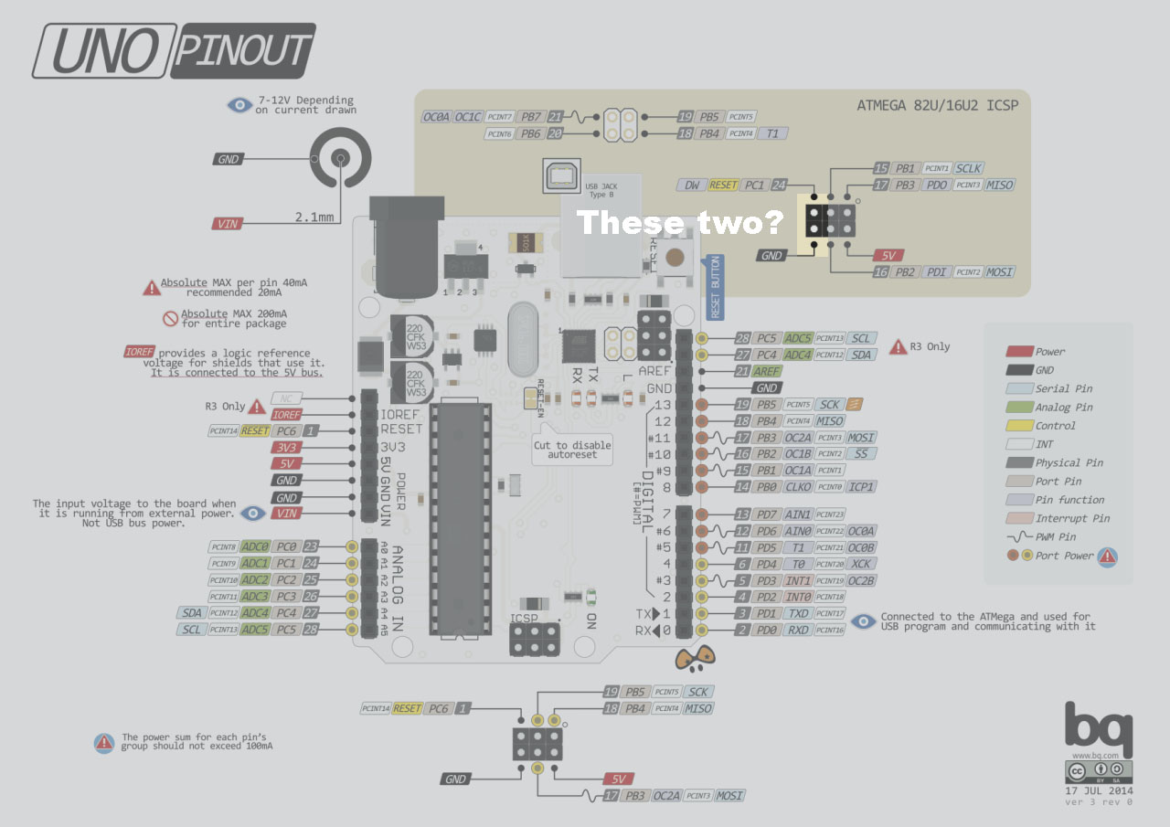

There are two ICSP headers on the UNO (R3) board, one for the 16U2 USB to TTL converter, and one for the mega328. By placing a jumper between pins 5 and 6 on the latter one, you disable the mega328 in which case all its I/O pins are open and you can connect your Pro Mini TX and Rx to pins 0 and 1 to communicate with the USB to TTL converter. There is no interaction between reset on the mega328 and reset on the 16U2.

You're saying I can put a jumper on my uno, and I'm good? As long as I do a manual reset?
Where do I put this jumper?
lil_satan:
Paul__B:
Connect Reset to Gnd on the Power header - same effect as pushing & holding the Reset button.
Will not damage anything.

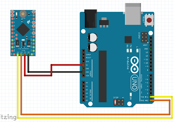

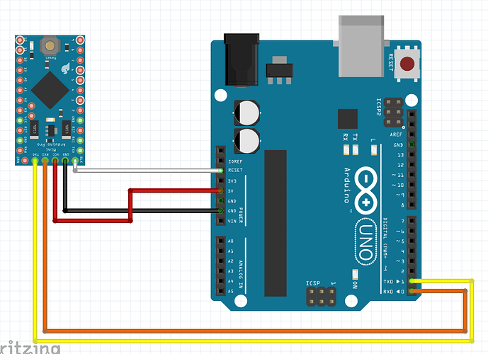

Sooo...
Just to be clear...

So this is how to wire it with the ATMega328 chip REMOVED..
And this is how to wire it with the chip still in, and jumper on ICSP pins 5,6. With reset wire functioning...
In #11, Reset is connected to GND on the Promini.
In #12, Reset is not connected.
I think your descriptions are a little mixed up.
In #11, Reset must be connected to the terminal labelled "GRN" on the Pro Mini.
#12 is correct - with the Reset jumpered on the UNO, you have to use the reset button on the Pro Mini.
Note that the "FTDI" terminals on most "clone" Pro Minis as well as the original "Mini" run in the opposite direction to that shown which is for the original Pro Mini.
