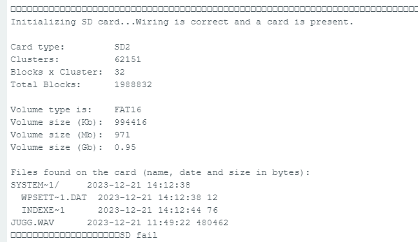

This subject seems to be pretty popular but I cannot seem to find an answer to my issue. I am hoping someone can assist. I am new to Arduino and just got an Uno R3 and I am trying to play a .wav song from an SD card through an 4ohm 3 watt speaker. I have ran the Cardinfo sketch example in IDE and the SD card is being recognized and read but when I run try to run the sketch to play the song I get an "SD fail" message. I have included the code, the Cardinfo script, type of SD card module I have, and an attempt to show wiring (with Tinkercad) which I could not find an animation for the SD card so I just showed wiring.

IDE cardinfo+error
Please help. I have reviewed quite a few forums and dove into YouTube and I am still unable to find a solution. Thank you!

What you have in your sketch:
if(SD.begin(SD_ChipSelectPin))
What you need to make it work:
if(!SD.begin(SD_ChipSelectPin))
Thank you Van_der_decken! That worked perfectly!
