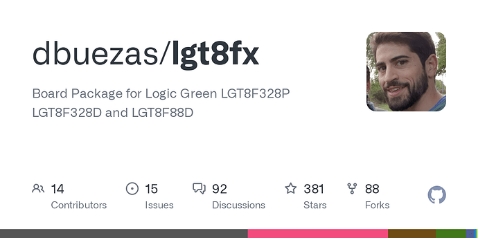

If you look closely at the product listing on Aliexpress, you will probably find a link or URL for one there. However, these are often low quality or difficult to install. I recommend instead using this nice community created "LGT8fx Boards" platform:
You can install it by following the instructions here:
https://github.com/dbuezas/lgt8fx#how-to-install
After installing the platform, select Tools > Board > LGT8fx Boards > LGT8F328 from the Arduino IDE menus. After doing that, you will find that several new menus have been added under the "Tools" menu:
