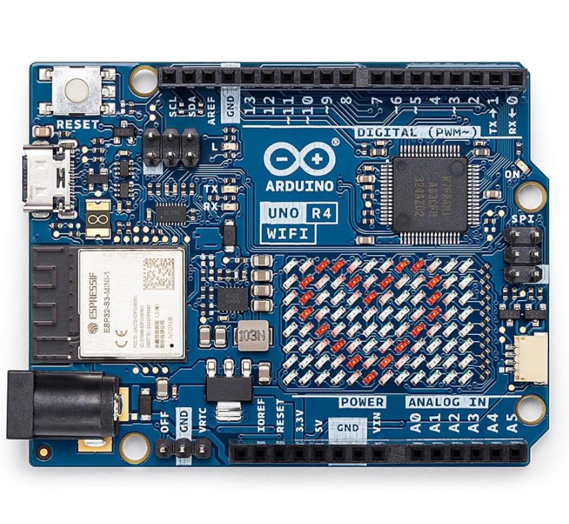

UNO R4 Bluetooth remote car using L298N giving command is not moving at all
Hi
I am using a Dabble application on my iPhone UNO R4 Wifi has built-in Bluetooth Have tried a looked in many places but no luck pls help.
I like to make it move forward and back right and left,
On top of that when I finished another two Dc motors on the same H bridge and 2 servo on PCA9685k go back
Ideally, I like to
assign DC motors 1 and 2 is to go forward and back and right so you can assign the 4 arrows to it
DC Motor 3 and 4 need to go forward and back,
Assign dc 3 to square and forward arrow to go forward and square and backwards arrow to go back
Assign DC 4 to the x button and forward arrow to go forward and c button and backwards arrow to go back
assign servo 1 to the triangle and the forward arrow to go forward and the triangle plus backwards arrow to go back
assign servo 2 to the circle and forward arrow to go forward and circle plus backwards arrow to go back

The Arduino comes up as a Bluetooth device. on the app
Also, see the hearth as I needed it
what I really need to be able to move forward back left and right now
later I can sweat through the arm, grip and the spin.
TBH
this is a salvaged code what I found and most likely that is why is not working
the trouble is that I connect the uno to my phone and press the arrow moving forward and nothing happens neither backwards right or left
Is there a way to have a print out of how the Arduino interprets the Bluetooth remote controller buttons so I can assign tasks for those functions?
Make a new sketch that just connects to the phone. Remove anything that goes to the servos and motors. Then use the Serial Monitor to see exactly what you are receiving from the phone.
The Serial.print() command can be used to print anything you like, such as values received from Bluetooth.
Do you have an example code pls?
Jeez I need help with this that is whyI asked help
I understand if is tooo hard for someone
I don't have anything you are using so I am literally just guessing here. Try this, if it doesn't work then break it down piece by piece. Look up tutorials and other examples, we can only do so much on our end.

Thank you are amazing, I will try it out when I get home. I am on the train from uni where I will have this as an assignment. Sorry for the questions.
My friend your contribution so far was not delta but minus -10.
There is no info out there for uno r4 wifi as most of the info is regarding older devices instead making it a useful thread people will have to read through all of this mouth karate… thx
I happy to read up on staff u have at hand and work out next steps but again just being negative-11
Mate I am married already don’t need more drama
So reading is hard in -12
I was saying I will do it when I get home atm I am in a train station….
At least time goes faster
It has connected on but not displaying anything atm I need to dive in a bit more still on the train will see if I can make it work tonight thank you for your help so far
