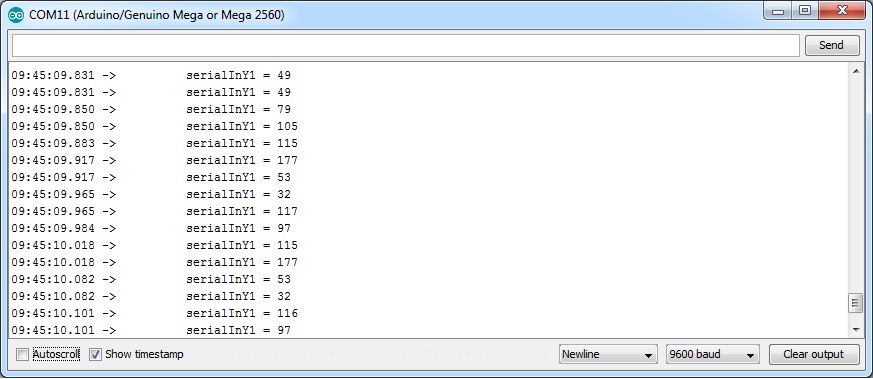

Okay, so here's what we get at the Receive end (see picture). I changed the code to send 177 instead of 170. So it's getting a 177 SOME of the time. Is something about Serial.read that needs to be configured somehow? Nobody ever writes anything about that, so we're stumped.

The whole problem is the fact that we're getting so many different values at the Receive end, instead of just the 177. It shows up every now and then, as you can see in the picture, but not usefully. Where are the other values coming from? If the GNDs are connected and the boards have a wire from Tx to Rx, I can't see what else there is to connect. The Tx light on the Send unit is on, but the Rx light on the Receive unit is not lighting up at all - just the Tx light (on the Receive unit, which has nothing connected to the Tx pin). Is that because the Receive unit is sending to its serial monitor through the USB cable? We have the two boards reading serial monitors on separate computers.

Okay, so my understanding of serial.print was that it sent to the serial monitor, not out the Tx pin. Isn't that what serial.write() does? If they both send out the Tx pin, then how are they different? In any case, thanks for the idea. I'll give it a shot and see what happens on the Receive end.

The main point is that it now works! Thanks so much to everyone who contributed their thoughts and ideas, especially the sample code, which I guess simplified the send so much that it became readable. Here is what works now, using a joystick for input and sending it to the Mega, which can now read all of the serial inputs it gets, without other weird numbers (presumably created by serial.print commands being read as bytes or whatever).
