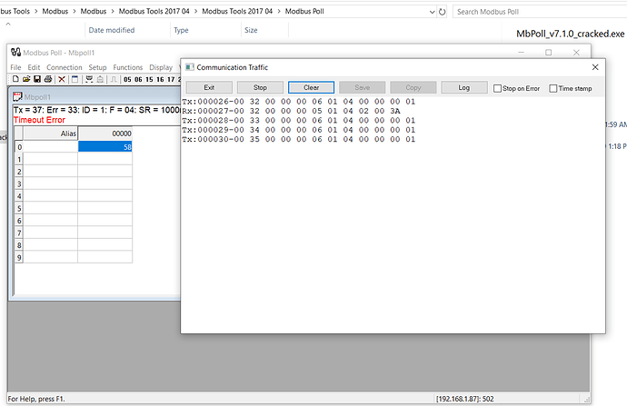

Dear community:
I have a UNO R4 WIFI that I just bought and I want to use it as a remote Input/Output station using the ModbusTCP server over my home LAN network. I have an Opta WIFI working as a MODBUS TCP MASTER and I can see the UNO R4 WIFI in the same network as the Opta and I can even send and receive data using Modbus Poll simulation tool, however I get connection timeouts. So in other words It is an intermittent connection to the UNO R4 WIFI and it takes like 5-10 Tx request to get one Rx the it repeat again.
I have tried different libraries but nothing seems to work 100%.
The Sketch below is the closest one working.
Any suggestions on how to solve this issue?

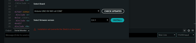

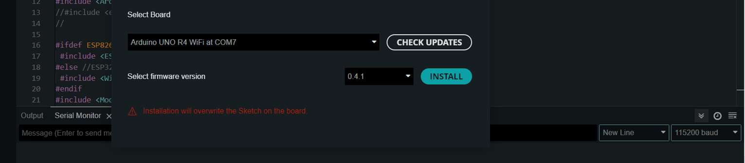

In the following pictures I show the FW version I'm using and the Modbus Poll behavior:
