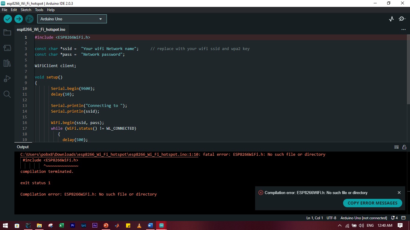

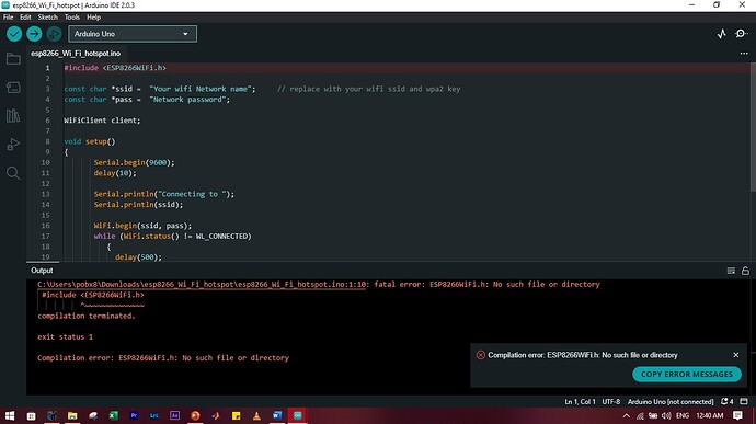

just because the uno wifi can connect to a wifi client/AP easily out of the box with the help of First Configuration or i thought so, and in case of esp8266 boards you have to do this manually and my board is giving me the following error.
P.S. The Esp8266 libraries and board manager are already installed.
Please do not post pictures of code and error messages. Use code tags when posting either
Do you see the button entitled "COPY ERROR MESSAGES" ? Guess what that does
You have the target board set to be a Uno but are compiling code for an ESP8266 so no wonder that the library file cannot be found
