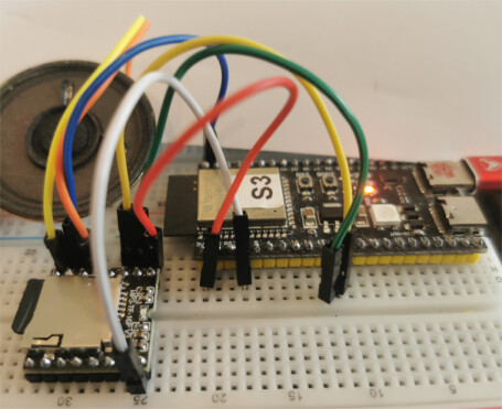

Unsolvable DFPlayer Mini (clone) communication issue with ESP32-S3 (Works with Arduino Uno)
Hi everyone, I'm really stuck on a baffling issue involving an ESP32-S3 and a DFPlayer Mini module. After days of debugging, nothing makes sense anymore—maybe someone here has run into something similar?
The Goal:
A simple project: play an MP3 file from a DFPlayer Mini using an ESP32-S3 (with a display and keypad later).
The Problem:
  • When connected to the ESP32-S3, the DFPlayer Mini is either completely silent or, under certain wiring configurations, outputs a loud, continuous digital noise (like a "tractor" sound) from the speaker. The ESP32 code reports that the DFPlayer is not responding.
  • When the exact same DFPlayer Mini, SD card, and speaker are connected to an Arduino Uno, everything works perfectly.
So the DFPlayer module, SD card, MP3 file, and speaker are all fine. The issue is clearly with the ESP32-S3 setup.
Hardware Used:
  • Microcontroller: ESP32-S3 development board
  • DFPlayer Module: MH2024K-24SS based (PCB marked MP3-TF-16P V3.0).
  • SD Card: Known-good card, FAT32 formatted using the official SD Card Formatter. Contains a /mp3 folder with 0001.mp3 (128kbps CBR).
  • Power Supply: Stable 5V 1A wall adapter powering the ESP32 via USB.
  • Logic Level Shifter: 4-channel bidirectional (BSS138-based)
What I’ve Tried (Summary):
Using the Arduino Uno, everything works without issues. A simple setup with a resistor on the RX line is enough to get the DFPlayer playing audio immediately.
With the ESP32-S3, nothing works. I’ve tested both direct connections (with and without a resistor) and setups using a proper bidirectional logic level shifter. In one case, I get loud digital noise (even with the SD card removed); in the other, the module stays silent and player.begin() always fails. The level shifter itself works fine—I verified it with a loopback test.
I’ve tried multiple UARTs (Serial1, Serial2, main UART) and different pins, but no luck. The main UART even interferes with uploads when the DFPlayer is connected.
I also cycled through all common baud rates, including 9600, 4800, and 19200—none of them worked.

Post an annotated Schematic, showing exactly how you have wired this. Be sure to include all components, power sources etc. A clear picture would be nice as well.
The ESP32-S3 uses 3.3V level signals, yes? So why would you feel the need to use a level shifter to communicate with the DFplayer, which also uses 3.3V level signals?
My ugly schematic
And a fast fritzing copy
To be honest, I don't know — it was just an attempt, because it worked with Arduino (at 5V, I suppose), so I gave it a try. Yes, it does use 3.3V though. Anyway, even without the level shifter, it still doesn't work

Out of curiosity, do you have any other ideas on what could be causing this? I’ve seen many tutorials where the DFPlayer works just fine with an ESP32 (even without a level shifter), but for some reason I can’t get it to work with the S3. It’s really puzzling.
the following code works on a ESP32-S3-DevKitC-1

Ok, it’s black magic but it works! So, it was probably the 5V causing the issue, because now that I’m using 3.3V it works fine (just some occasional noise). I tried switching back to 5V and yep, that’s definitely the problem. Thanks a lot, my friend!
I didn’t quite understand your diagram.
But can we agree that the +5V pin on the ESP32 is an input, not an output?
Also, is the BSS138 fast enough to keep up with a UART?
In general:
The input of the MP3 module can work well with the output levels of the ESP32 because it's at 3.2V, but not the other way around.
The MP3 module has outputs at 5V, so you should use a voltage divider between the TX of the MP3 module and the RX of the ESP32 — not the other way around.
With two resistors — one 1 kΩ and one 2 kΩ (or two 1 kΩ resistors for a total of 3 kΩ) — you should be able to level the voltage down from 5 V to 3.2 V.
If you're powering with two different sources, such as two power supplies, it's best to connect the two grounds together to have the same voltage reference with respect to ground.
