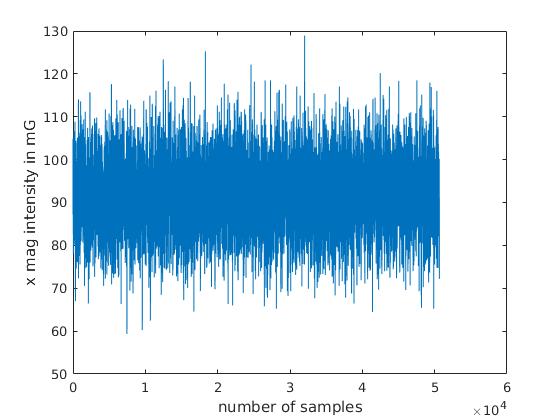

The magnetic field data also seem noisy even when the IMU is stationary placed on a flat table.

your data:
Total
170 95 550 583
325 60 100 345
26 400 240 467
120 440 190 494
320 15 30 322
390 15 220 448
This tell you :
  • the sensor is inexpensive..
  • There may be a nearby source that affects the mag.field
  • use additional data from other sensor to navigate
Try spinning the sensor on a surface tilted 14.1deg (mag. inclination, 2 deg west) .. where two axis shows zero
This will show you that a MEMS-sensor isn't accurate
