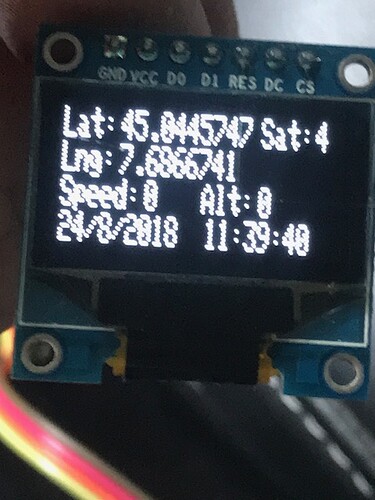

I am realizing a GPS tracker based on gps module as described in subject of this topic.
I read data (Lat, Long, Number of satellites, date & hour, Speed) and I print all on a OLED 1306 (128 x 64 pixel). I submit the code, without SD file writing.
The problems are the following:
  1. sometimes , the gps module takes really a lot of time to "wake up". There is any method to "wake up" (and to put in "sleep" mode) excluding to use a digital pin of the arduino nano ?
  2. Often the "gps.satellites.value()" function is returning zero but the lat/lng values are updating anyway. Also the gps. altitude.meters() is returning zero and rarely gives an altitude output, even if the number of satellites is higher than 3 or 4.
Do I miss something or making some mistake ?
There is somebody that can give a suggestion about these questions ?
I thank you very much for helping.

The GPS module has to know exactly where the satellites are in the sky to work at all, and when off or sleeping maintains an internal data base with approximations for their positions.
After waking or turn on, depending on the number of satellites present and the accuracy of those approximations, it can take minutes to determine a fix.
There is nothing you can do about that other than use a good antenna and have a clear view of the sky.
Each GPS position sentence contains a flag stating whether the position is valid. Check that flag and don't use the information if it is invalid. See the TinyGPS++ documentation for validity tests.
GPSs can take a long time to aquire a fix, the first time they are powered on, this is normal behaviour.
Your displaying the data from the GPS when the location has been updated, this does not necessarily mean the altitude has updated ...............

Hi. I did not solved yet altitude problem..working on it to analize data in a better way to achieve quality logs files.
I have checked out the file on the SD card (did not published the code) and using google maps seems to be very precise. But.....sometimes there is some faulty coordinates, but need to understand if the problem is caused by GPS, or SD, or arduino and SD communication. But I have to say that 99,99% of recorded data can be classified as "good".
Regarding altitude I will check possible solutions.
Regarding the "turn on" delay, it seems there is not so much to do as stated by jremington.
It depends on various matters: time passed between last use and new powering on, signal quality, antenna performance and so on.

A position variation from a GPS is normal behaviour, even under good reception conditions and with a good antenna, +- 10m or more can be normal.
Under not so good conditions, perhaps as much as +- 50m to 100m.
These are not 'faulty co-ordinates' as such.
Thanks Srnet. I understand. As "faulty coordinates" I ment "very large position error".
From the log.txt file all coordinates where very precise (even much less of +/- 10 mt...).
But in one case (one record line), I found myself in Ireland instead of North-west Italy...maybe could be a first step for tele-transportation :grinning:
Maybe this faulty line is due to arduino/SD module miscommunication. I don't know.
