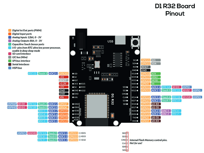

Let me first introduce my device:
Device Name: Wemos D1 R32
Features:
  • Chip: ESP32-D0WD-V3 (revision v3.1)
  • Features: WiFi, BT, Dual Core, 240MHz
  • Crystal: 40MHz
  • Microcontroller: ESP-WROOM-32
  • Operating Voltage: 3.3V
  • Digital I/O Pins: 18 (of which 4 provide PWM output)
  • Analog Input Pins: 5 ADC
  • Serial Support: I2C, SPI, UART, I2S, CAN
  • Flash Memory: 4MB
  • On-board Wi-Fi: 802.11 b/g/n, BT 5
  • Bluetooth v4.2 BR/EDR
  • 240 MHz dual-core ESP32 chip
  • USB-to-Serial converter: iFT-232-S16
  • Dimensions: 68.6mm x 53.4mm
  • Supply Voltage: DC 5V to 12V
