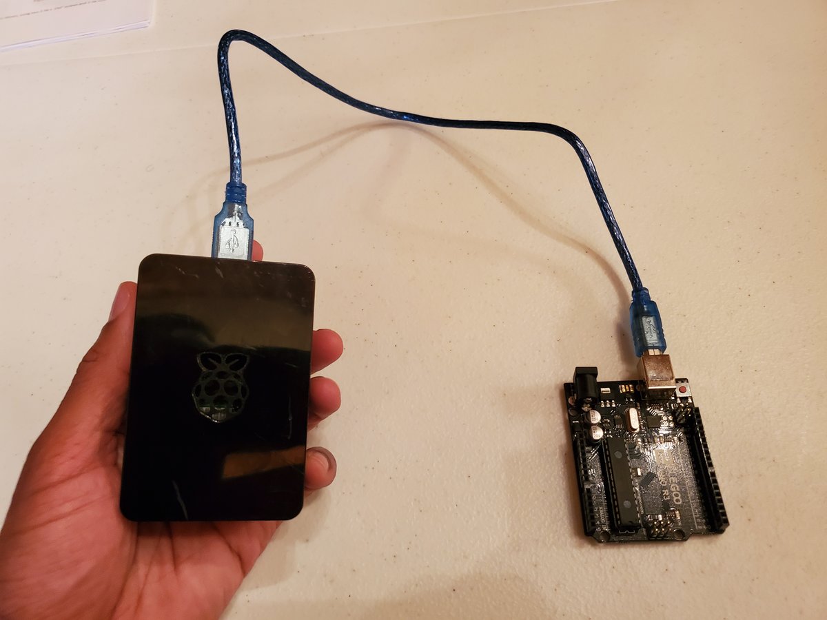

Hi, I would like to upload my code as soon as I open the Arduino IDE, is this possible?
I am using an arduino UNO, programmed by my raspberry pi 4, if it helps.

My solution was to use python to send code along the serial port.
I found it in this article:
