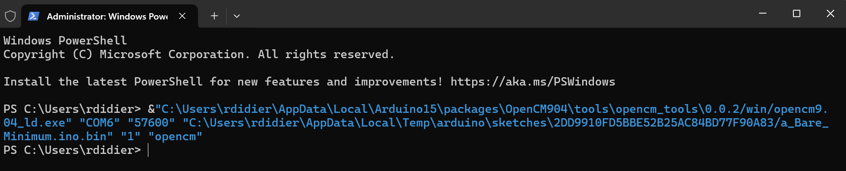

Hi @rouno69. Please try this experiment and then report back here with the results:
:exclamation: This procedure is not intended to solve the problem. The purpose is to gather more information.
  1. Right click the Windows "Start" button.
    A context menu will open.
  2. Select "Terminal" from the menu.
    A PowerShell window will open.
  3. Type the following command at the PowerShell command prompt:
    &"C:\Users\rdidier\AppData\Local\Arduino15\packages\OpenCM904\tools\opencm_tools\0.0.2/win/opencm9.04_ld.exe" "COM6" "57600" "C:\Users\rdidier\AppData\Local\Temp\arduino\sketches\2DD9910FD5BBE52B25AC84BD77F90A83/a_Bare_Minimum.ino.bin" "1" "opencm"
  4. Press the Enter key.
When you did that, did you see an error message, or did the process complete as expected? If you see an error message, please paste the full text of it in a reply here.
When you did that, did you see a dialog box pop up? If you see a dialog, please post the full text from the dialog in a reply here.
The hope is that running the command from the terminal will provide us with better information about the problem than the very cryptic "exit status 0xc0000135" we are getting when Arduino IDE runs that command.

@ptillisch , I pasted the command in the terminal but don't get any message
