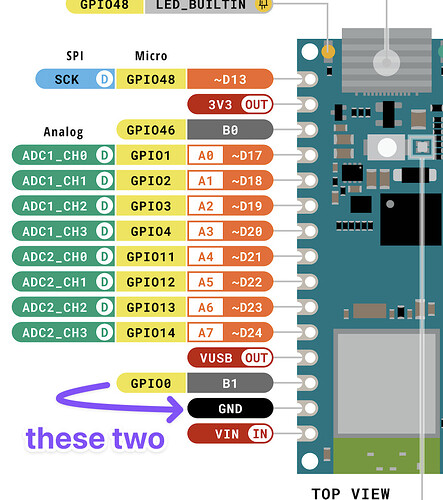

Trying to program a new Nano esp32, but flashing is intrerrupted every time between 0-30%.
I'm trying to upload an empty sketch and blink, nothing seems to want to stick.
Any ideas?

Might be some sort of USB trouble you're going through, but I still suggest you try a recovery path:
  • unplug the board
  • use a jumper to connect B1 and GND (see picture)
  • LED will become Blue
  • open a blink sketch
  • select the board from the board manager
  • in the menu Programmer, select esptool
  • select "upload using programmer"
This will reflash the Arduino bootloader and should get the board back to life.
Once this is done, disconnect the board from the computer, remove the jumper, reconnect and try again
Thank you! I’ll give this a try!
Sketch uses 286853 bytes (9%) of program storage space. Maximum is 3145728 bytes.
Global variables use 30732 bytes (9%) of dynamic memory, leaving 296948 bytes for local variables. Maximum is 327680 bytes.
usage: esptool [-h]
               [--chip {auto,esp8266,esp32,esp32s2,esp32s3beta2,esp32s3,esp32c3,esp32c6beta,esp32h2beta1,esp32h2beta2,esp32c2,esp32c6,esp32h2}]
               [--port PORT] [--baud BAUD]
               [--before {default_reset,usb_reset,no_reset,no_reset_no_sync}]
               [--after {hard_reset,soft_reset,no_reset,no_reset_stub}]
               [--no-stub] [--trace] [--override-vddsdio [{1.8V,1.9V,OFF}]]
               [--connect-attempts CONNECT_ATTEMPTS]
               {load_ram,dump_mem,read_mem,write_mem,write_flash,run,image_info,make_image,elf2image,read_mac,chip_id,flash_id,read_flash_status,write_flash_status,read_flash,verify_flash,erase_flash,erase_region,merge_bin,get_security_info,version}
esptool: error: argument --baud/-b: invalid arg_auto_int value: '{upload.speed}'
This is all I get
Hello @Chris_Beeves, what OS are you using? Can you try updating your IDE to the latest version available here?
I'm using W11 and 1.8.19 (IDE2 doesn't start on my PC)
I'll try using my old laptop..
It's aliiiive! Thank you.
