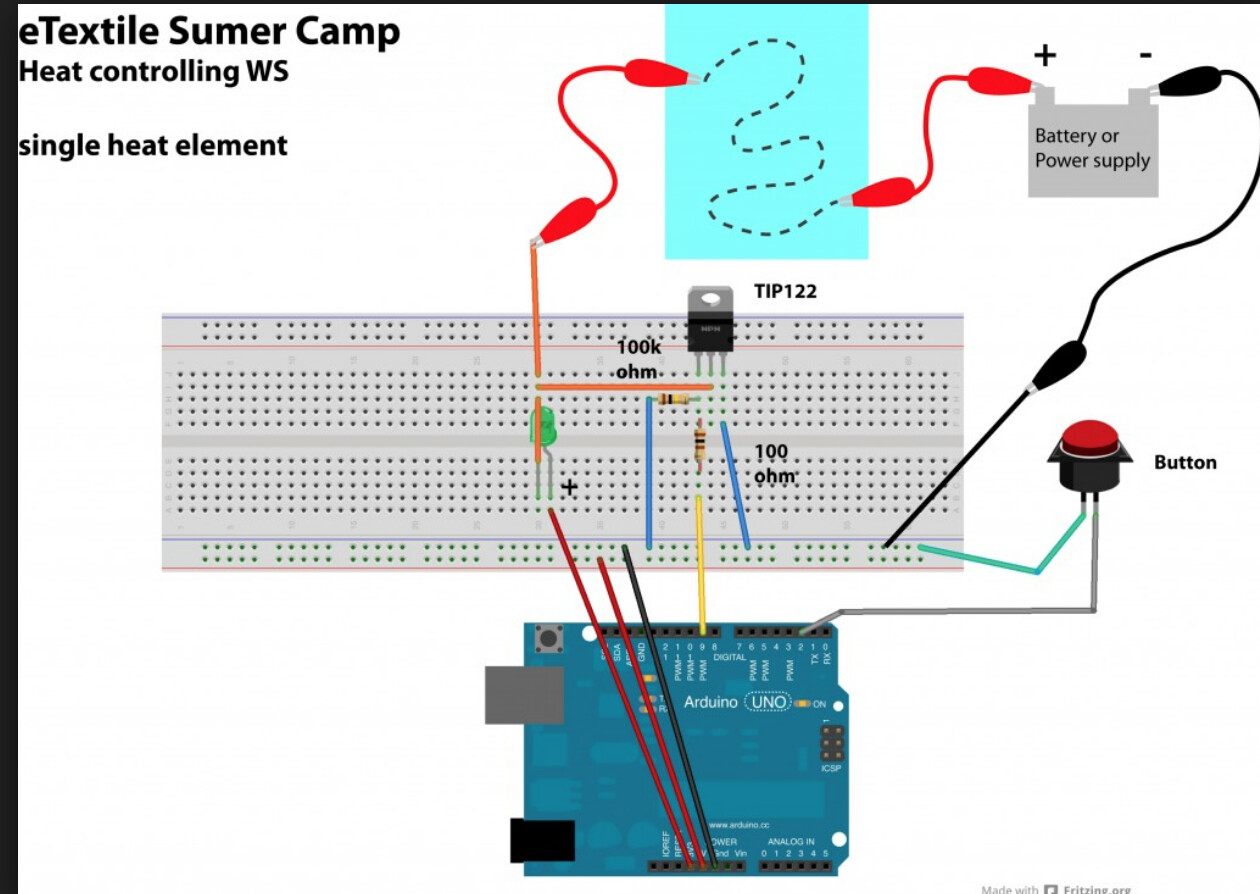

Hi Folks,
I’m new enough to arduino, so excuse my lack of knowledge on this matter. Essentially I have a circuit set up with a Tip122 transistor that switches the circuit which turns on the heat pad. Currently I have a button to turn this on and off. What I’m looking to do is substitute the button with a capacitive sensor to turn it on and off.
I’ve attached a schematic of the heat pad circuit and I’ve also attached a schematic of the capacitive sensor circuit. Essentially I want to add the capacitive sensor circuit to the existing heat pad circuit, remove the button and substitute it with a capacitive sensor
I hope this makes sense

What you want to do sounds possible.
So you’ve set up the heating pad, you have some code for it (which you haven’t shown us) and it works. Good start.
Now you need to set up the capacitive sensor circuit, find or write some code for that and get that working, switching something, maybe an LED.
When you’ve done that you can have a go at putting the two programs together and post your attempt here, telling us what works and what doesn’t.
Then we can help you.
I cannot find that one.

Doesn't the green LED need a current limit resistor?

Capacitive touch sensors stand and fall with good grounding of the project, so battery power usually doens't work.
Or look into ready made touch sensors, based on the TTP223 IC. Haven't tried on battery yet, expect that to work as well. They work great on normal power.
