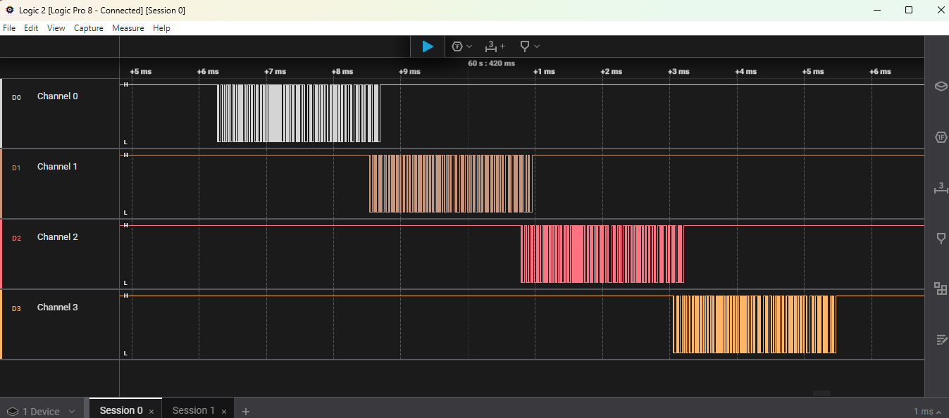

default implementations for Serial is to not buffer writes, That is if you do something like:
Serial1.begin(115200);
Serial2.begin(115200);
Serial3.begin(115200);
Serial4.begin(115200);
delay(250);
Serial1.println("abcdefghijklmnopqrstuvwxyz");
Serial2.println("abcdefghijklmnopqrstuvwxyz");
Serial3.println("abcdefghijklmnopqrstuvwxyz");
Serial4.println("abcdefghijklmnopqrstuvwxyz");
You will find out that the Serial objects are not buffered and your code sits in the Serial prints until the last character is output into the hardware buffer. As you can see if you look at the
logic analyzer output:
Note: this is true with the UNO R4 boards as well. But if you do the same on most other boards
the data is put into queues and all of the UARTS are outputting at the same time. For example I dragged out a real old MEGA 1280 and ran the same sketch minus Serial4
Sure enough:
Note: if I remember correctly, for some reason, Arduino decided to use the unbuffered Serial code within MBED for the hardware Serial objects. I believe one can use a buffered version of the code. I remember there was a thread where somone was able to use it.
Will it be fast enough? Maybe... Again, the best thing is to try it and see...
Good luck
Kurt
That's interesting, and somewhat surprising as well. Although depending on the application, it may be tolerable. Thanks for pointing it out!
Found the two spots on the forum that mention the buffered Serial class, including:
Thanks for the info. I've now switched to using the mbed::BufferedSerial class directly for all but my blackbox serial device / usb console. Performance is blistering. I've retained Serial for those cases where I'm using Print funcs. Still considering best options for switching them to buffered. Update: blackbox now migrated. Keeping console on blocking SerialUSB
