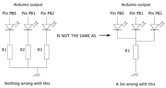

In addition you have connected up the LEDs wrong, if you want more than one to be on at any one time. You need separate resistors in the anode, not one in the cathode. As you have it once you have the red LED on, (the one with the lowest forward voltage) then no other LEDs will be able to light up because you won't be able to get enough voltage to turn them on.

Not one I can agree. But can you explain why on the anode side and not on cathode side. Never had problems with that. Knows the led on what side the resistor is?

For a single LED it does not matter what side the resistor is on. But this is a common cathode LED so all the current from all three LEDs goes to the same resistor. So
  1. the LEDs, if they were the same colour, would change in brightness with how many were on.
  2. as I said if they were different colours you could only get the one with the lowest forward voltage on.
Have you ever tried this?
I guess the answer is no because if you had you would have found out it is correct.

You say
I say anode or cathode make no sense. I say both situations below are the same. The LED never knows where the resistor is. He hasn't that intelligence.
Show me the URL that say that a resistor in the kathode line is bad and short the LED life.
After >40 years with electronics I know how to work with leds.
BTW on the schematic are three different leds. Three leds in one case has another symbol and has only one component name. If TS will use only one of them and not together, there isn't a problem.
Clearly you are missing something that eluded you for 40 years.
I have had over 50 years in electronics, I started before LEDs were even a component you could buy.
Don't be silly. The two diagrams you just posted are not in any way shape or form equivalent to the LEDs in the diagram I commented upon. If you can't see that then it is not my fault.
The LEDs I commented about have a single common resistor in the cathode (not kathode - it is not often that a dyslexic like me is moved to correct spelling) that means all the current from all the all the LEDs are going through a single resistor.
You would have the same problem if you put all the LEDs cathodes to the output pins and had a single resistor pulling up to 5V.
So it is nothing to do with the resistors being in the cathode. It is to do with having a single current limiting resistor.

So I suspect you can not read my language very well, which to give you the benefit of the doubt, is probably why you are misunderstanding what I am saying. So here it is in schematic terms.
Now do you get what I am trying to say?
Or do you insist that those two circuits are the same thing?
YES I SAID THAT!
