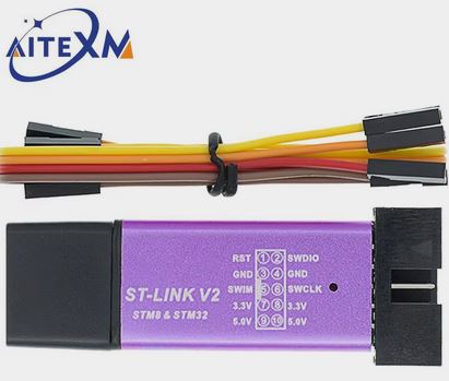

Buy a $2 St-Link programmer, it makes the uploading much easy.
https://aliexpress.com/item/32887597480.html
I guess programming with ST-Link works without bootloader and then there is no Serial Monitor available for debugging?
Can ST-Link also be used for debugging?
Serial monitor has nothing to do with bootloader, you still able to use Serial if you upload the code via St- link
Hi @SupArdu.
