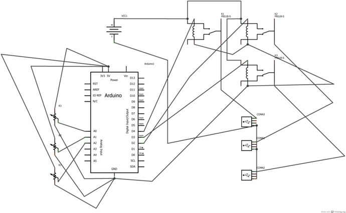

I am working on constructing a box which has three USB ports which will only be used to power USB devices and not use any data features. The key to this project is to have the power to each female USB port be determined by potentiometer setting. I think I have a pretty good idea of how to do this (relays), but I have a question about power consumption:
See I would like it so this box would only have one power plug on it which would power the Arduino and also the USB ports. What would you think an appropriate power supply would look like? Clearly it must be 5Volts but how much current would I need? If I got a 5volt 2.5A supply would it be sufficient? I am not sure how much current the devices connected to the usb port would draw? Also if you could give some guidance on wiring this together, could I just connect the power supply to everything in parallel?

The kinds of devices are small USB powered heaters, and other random stuff, I'm not 100% because I was just asked to build it :} .
What I meant by the power being controlled by potentiometer is:
The potentiometer controls the timing of when the USB has power, so for example you could set the potentiometer to "6 hours" and then the USB will receive power for 30mins every 6 hours.
So I guess if the USB is rated for 500mA that means that I should get that 1.7Amp power supply and just leave it at 5 volts? Will it work fine if I send the power supplies' power to each source (3 USB ports and Arduino) in parallel? Is that all I'll need to do? The Arduino will need power to switch the relays...
Here is a crude diagram of what I'm trying to do, just imagine the battery pack is our power supply:
That might be correct, but honestly without a proper schematic drawing it's almost impossible to see if you got a correct concept or not. A schematic drawing is the universal language of electronics not that clown pictorial representation that some arduino people like to use. Sorry, pet peeve, rant over.

Can you give me a suggestion on free schematic software? The one I'm using clearly isn't the most elegant..
That is one ugly schematic, but you know what, it does the job of explaining what and how you want to accomplish something and that is the main point. So it's much better then the clown pictorials.
Now on to your project. In overall concept it looks good to me. The only detail problem I see is with the relay coils. Unless you pick out small 5vdc reed SPST relays (you don't need SPDT contacts as you show as you aren't using the normally closed contacts anyway) that have current draw of 30 ma or less then you will need to add switching transistors between the output pins and the relay coils. And you should always wire a reversed biased diode right across each of the relay coil's terminals to prevent voltage spikes when the coils are de-energized.
But other then that the hardware design looks OK to me. Added features might be to fuse each voltage applied to each USB connector so that if one user shorts out it doesn't effect all the other USB users or the power supply.

Yeah SPST is what I had planned on using just the cruddy schematic software only had one relay model. When you say that I require switching transistors between the output pins if the relay draws more than 30mA are you referring to the "coil current" spec on the relay. I have a project where I use 3 x 42mA "coil current" relays and nothing between output, and it functions fine. I take it this is not best-practice, if possible could you break down why you would add the switching transisors?
I will be sure to include the fuses and diodes.
I am glad that all I need to power all devices is to wire them all in parallel with the power supply, thought that'd be trickier.

I suggest you check whether you are required to provide a regulated 5V supply, and whether your proposed supply actually is regulated. If it's only powering heaters and chargers and so on they might not care, but electronic devices powered from a 5V supply would typically require that supply to be smoothed and regulated. The Arduino, for instance, won't like it if your supply is significantly different to 5V or has any noise on the line - and it doesn't sound as if you know or will have any control over whether any of your attached devices are generating noise.
From your later comment is seems to me that you have been overloading the I/O pins on the other Arduino and also not providing flyback protection. I suggest you fix that ASAP and don't make the same mistakes here.

The stuff connected to USB are pretty basic devices, just drawing the power from the USB so I'm not worried about noise or voltage spikes with them. The power going to Arduino of course I am worried about, although I know Arduino has an onboard voltage regulator, would that provide enough protection (keep in mind this is not mission critical ;))?
For between the I/Os and relays you are talking about flyback protection, should I use those transistors lefty I was talking about? I looked up flyback protection and I found that there were specific "flyback diodes" , could I use one of instead and be safe?

I don't know what 'pretty basic devices' means in electrical terms.
If you power the Arduino from a 5V supply via the USB connected then you will be bypassing the onboard regulator and any noise in the supply will go straight into the microcontroller.
