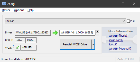

At last I was able to reproduce your error with a USBASP adapter with fischl firmware
Only when I install a libusb0 driver for the USBASP I get your error
I am using Zadig for swapping drivers
on the left side you see my active driver, which then results in this error

When I change back to the WinUSB driver or the LibusbK driver (select "replace driver") the error dissapears.
resulting in:

So I recommend you check with Zadig, which driver you have and change if needed.
When using Zadig, make sure to select "List all devices" from the options menu. Or you won't see your USBASP.
Yep, that helped, works now... :nerd_face:
