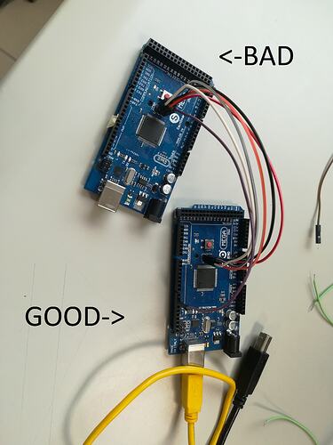

This is my set up
Missing something?
You're still connected to the wrong ICSP header on the bad board. CONNECT TO THE ICSP HEADER NEXT TO THE ATMEGA8U2 ON THE BAD BOARD!

make sure you didn't wire the ICSP2 header up-side down.
@Juraj this is my connection. The bottom board is the good one. Is this correct?
The wiring looks correct to me.

In software, I do:
  1. Connect good board to PC
  2. Open Arduino IDE
  3. Configure board as "Arduino as ISP"
  4. Upload Example "ArduinoISP"
    -- Then I connect all the wires (unplugging the USB) as the previous image
  5. USB plugged to the good board, I open a cmd terminal and execute the following command:
C:"\Program Files (x86)"\Arduino\hardware\tools\avr\bin\avrdude -C"C:\Program Files (x86)"\Arduino\hardware\tools\avr\etc\avrdude.conf -v -p atmega2560  -c stk500v1 -PCOM4 -b19200 -U flash:w:MEGA-dfu_and_usbserial_combined.hex -U lfuse:w:0xFF:m -U hfuse:w:0xD9:m -U efuse:w:0xF4:m -U lock:w:0x0F:m
I remind that the wrong board is SainSmart Mega 2560 with chip MEGA8U2 and the good one Arduino (original) Mega 2560 with chip MEGA16U2.
Is the command correct? I don't know what else to do. Thanks
then the only conclusion is that the 8u2 is dead
Is it possible to check with a tester if the USB is dead? How?
