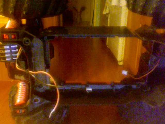

I am fairly new at using Arduino and I had a question. I have an old R/C car and I just bought a Futaba attack-4 FP-T4NBL channel 38 72.550MHz transmitter and receiver and I was wondering if I could attach the receiver (with four channels) to my Arduino as an inputs and the attach the right outputs to the motor and servo so I can use the control stick to control the R/C car? Here are some pics. In the photo of the R/C car the wires on the left are connected to a servo that controls the steering and the wires on the right go to the motor. Hope the pics help explain what I want to do.

The servo on my R/C car has only two wires, a black and a brown. I thought they were suppose to have three, a ground, power, and a signal. What do I do and how do I wire it to my Arduino?
Never seen one of those.
Can you post a photo of your servo?
I found out that the "servo" that had two wires was actually a motor. But I'll still will try to get a photo of it.
