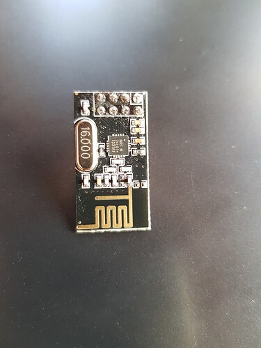

I attached the photo of my module which is a little bit different from the common ESP modules that I found on Google.
On the smd chip there is written this code “nrf24l01”.
I am not sure about the pinout because my module layout seems to be different from the standard ESP8266 modules.
"nrf24l01".
That is not a Wifi module. It is a 2.4 GHz radio module. It is a very handy part for communicating between 2 Arduinos (for instance) but will not do Wifi.

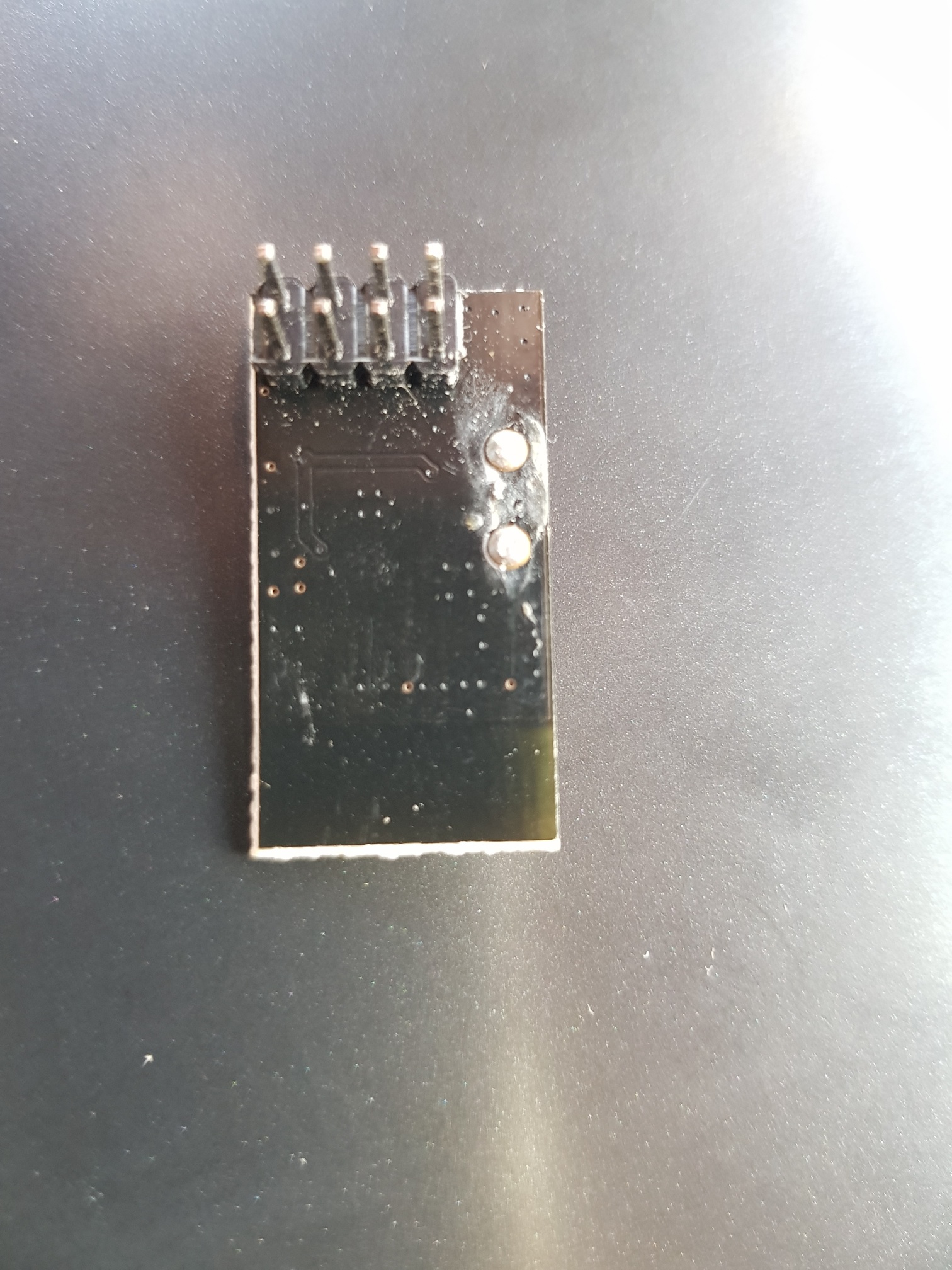

Can you take photos (as close and clear as possible and both sides, please) of the Wifi module and post it here? How to post an image.
This is the module I've bought:
|375x500
|375x500
I've bought the module from this link, code 808419. Please, note that the module I've received is not the module that is showed in the product description's page and this is very strange to me.
If this is not the correct module, I 'm thinking to buy this other one from this link, code 713678.
The module that you posted photos of is a RF24 radio module. Not for WiFi.
