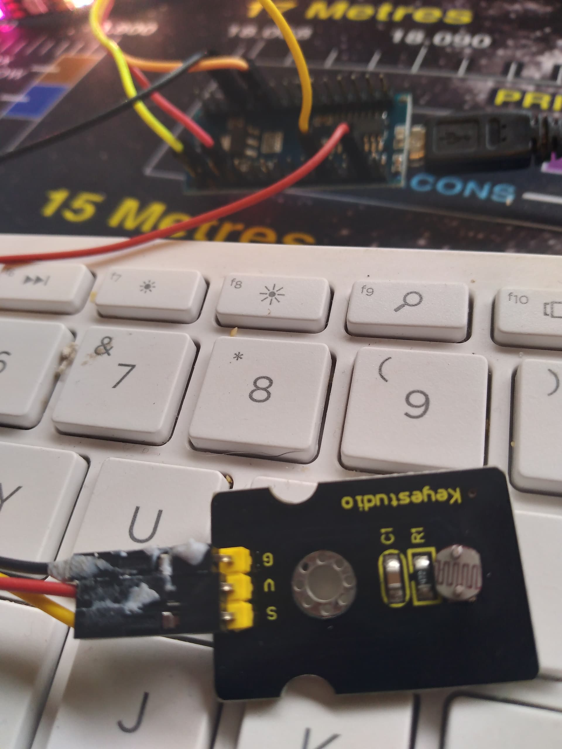

Hi all, I'm stuck with fastled example twinklefox. It will be a Christmas decoration so I would like to turn off the led strip during the day. I have used an LDR successfully before on other projects but the twinklefox code is far to complex for me.
My LDR code is like this:
if(LdrValue<240) {
  drawTwinkles( leds);
  FastLED.show();
 } else {FastLED.clear();}
I know it is simplistic, because it doesn't work.
Phil
  • Always show us a good schematic of your proposed circuit.
    Show us good images of your ‘actual’ wiring.
    Give links to components.
  • In the Arduino IDE, use Ctrl T or CMD T to format your code then copy the complete sketch.
    Use the < CODE / > icon from the ‘posting menu’ to attach the copied sketch.
Wrap the contents of loop() in the LDR condition...
  // setupy things
  if (LdrValue < 240) { // in darkness
    // everything twinklefox
  } // close brace for "if" condition
} // close brace for loop()
Thank you for your reply LarryD. This is the first time on this forum.
Following is my attempt to upload a picture and the code.

Thanks xfpd. That modification starts the display when it is dark but when it is light, the display 'freezes' and does not go dark. That is why I was thinking of something in an 'else' condition that maybe makes the leds go dark. That was as far as I got previously.
Phil
Yes, you could send the color "black/0,0,0/off" to all the ws2812 in the "else" part of the condition..
I was thinking of making an all black pallet and selecting that in the else but that is beyond my current capabilities.
Try this...
  else { // when sunny (I forgot if it is > 240 or < 240
    FastLED.clear();
    FastLED.show();
Thanks for your help xfpd this code works well!
LdrValue = analogRead(LDR_PIN);
if(LdrValue<240) {
  EVERY_N_SECONDS( SECONDS_PER_PALETTE ) {
    chooseNextColorPalette( gTargetPalette );
  EVERY_N_MILLISECONDS( 10 ) {
    nblendPaletteTowardPalette( gCurrentPalette, gTargetPalette, 12);
  FastLED.show();
  } else{FastLED.clear();
    FastLED.show(); }
