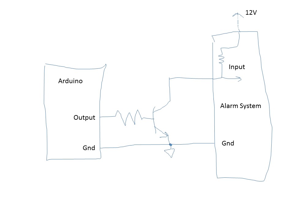

The internals of the arduinos run on either 5V or 3.3V so connecting your 12 signal lines directly will not work.
You can uae a transistor to 'increase' the output voltage of the arduino and a resistor based voltage divider to reduce the voltage to the input pins of the atduino.
If you power the Arduino from 12V, the onboard regulator makes 5V to power the board, and all IO is expected to be at 5V or less.
If the data line to be pulled low is at 12V, use a transistor with the base driven thru a 220 ohm resistor from the Arduino to pull the line low.
High from Arduino brings the input pin to the 12V device low.

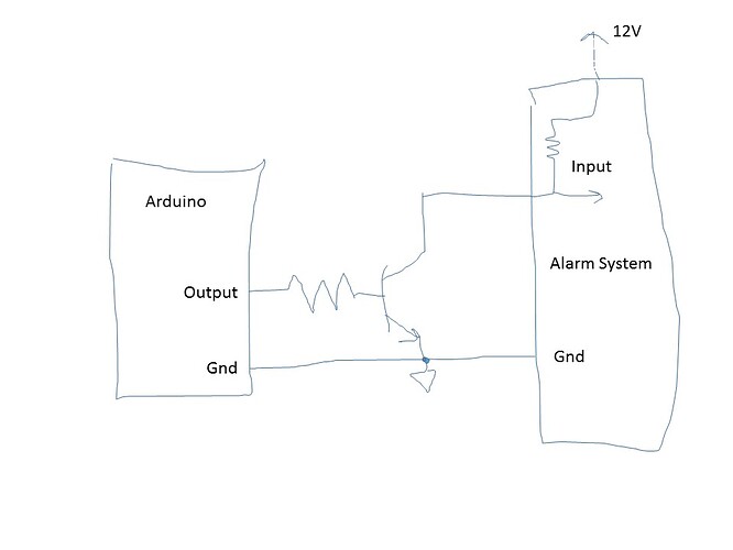

Took me a while to process the picture. The alarm is holding the signal high using a pull up resistor and when my digital pin applies a small amount of current after being assigned a value high, the transistor will pull the alarm system to a low/ground state. Forgive my limited knowledge here.

Is there a way that the data line attached to the arduino can be used for both input and output? I want to be able to capture keypresses on the physical panel, but also alter the data line to send virtual/programmatic keypresses using software.
It looks to me like the transistor setup is for output. Would that also work for input?

A pin can be used as Input & Output, just call pinMode when you want to change it.
If driving the transistor from the same pin, the input to your alarm will change also tho.

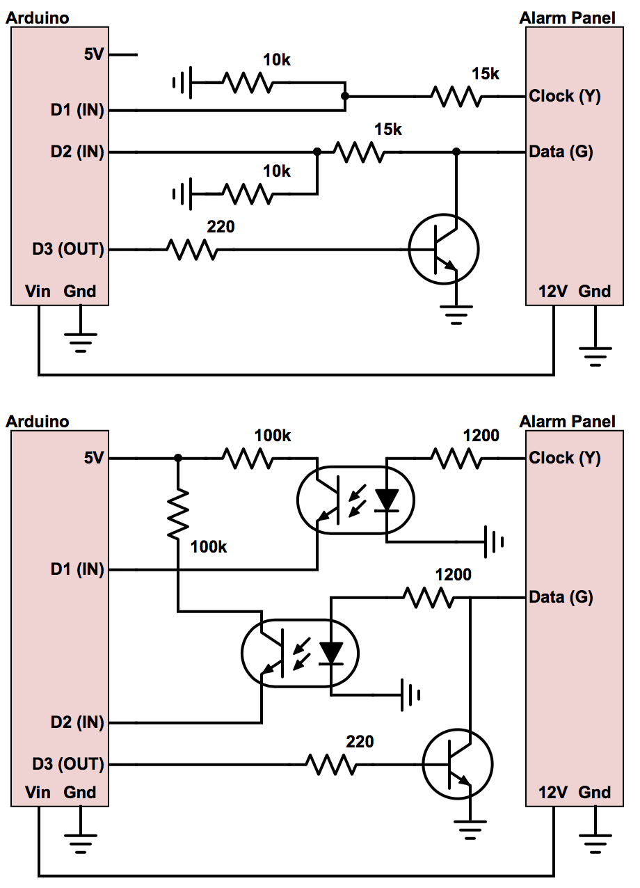

Use 10K to ground and 15K to +12V. The tap between the 10K and 15K will be 4.8V.
You MUST use a resistor to limit the current to the input LED of the optoisolator. 10 mA is good. For 12V, the resistor should be about 12V/0.01A = 1200 Ohms. For 5V, use 470 Ohms.
You MUST use a collector resistor on the phototransistor part of the optoisolator. Somewhere between 10K and 100K to 5V would be OK. The connection between the collector resistor and the phototransistor collector goes to the input pin.
Like this (Vi = 12V, R1=1200 Ohms, R2=100K)
If you wouldn't mind taking a quick look at the wiring diagram attached I hopefully captured what options I have. Appreciate all the help getting me going on this.
Either one should work, but I suggest to try the resistor divider version first. If you make a direct connection with a transistor to the "data" line as shown, there is no point in using optoisolators in the other direction.
If there is a genuine need for optoisolators between two devices, you have to be consistent and use them for every signal connection, plus there should be NO common ground or power connections.

Thank you for reviewing my plans. I tried the voltage divider option and at first glance it is providing reasonable results on both the data and clock pin and THE ALARM STILL WORKS !!!
I was just about to give up after torching my first arduino.
The optoisolator was only considered because I couldn't get the first option to work. Seems to be all in the choice of resistors.
