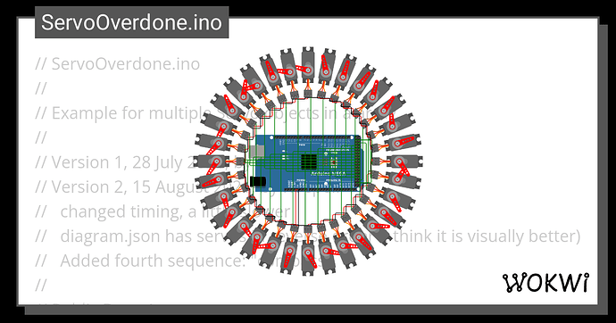

Even better, here's a complete example in the wokwi simulator, if you don't know, now you know:
I believe you can see all the same syntax used to create, intialise and manage a buncha servos.
The author does "cheat" and exploits the fact that the servos are attached at consecutive output pins.
a7

@J-M-L - TBC that's the work of @Koepel, early adopter and promoter of the simulator.
a7
ah OK - kuddos to @Koepel then

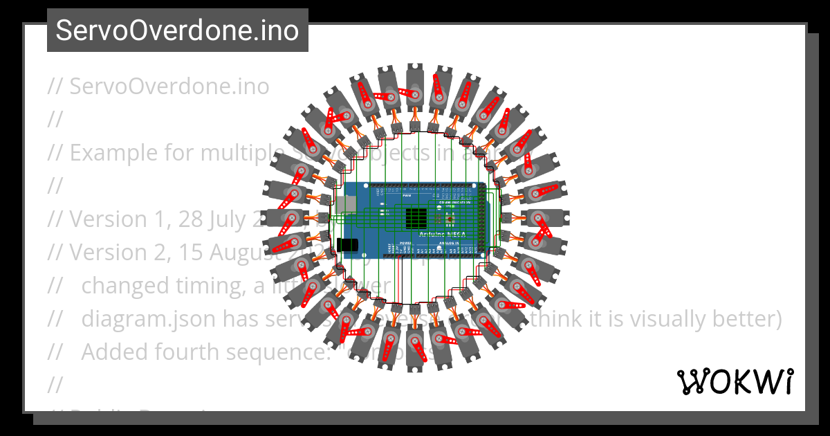

Thanks. The funny thing is that the positions of the servos are calculated in the sketch (which runs in Wokwi). It is the function "GenerateDiagram()" and its output is the circuit for Wokwi.
The Servo library uses a timer that triggers a interrupt routine. In the interrupt routine, all the PWM signals are made. It turns out that a basic Arduino board has no problems with many Servo signals.
yeah I've seen that , it's cool :slight_smile:
Nice work! Your sim is so much fun to play around with. Thanks for sharing it!
Watching it makes me think of Eddie Van Halen playing a killer guitar solo.
@Koepel Thanks for the simulator sketch, it's pretty cool. I was having an issue with Pins 45 &46 on my Mega. I could not get any PWM output on them. How did you solve this problem? I see in the dissuasion you were talking about the timer function, which I know get's used on these pins I think. I've done a basic servo.attach for each servo as I'm just testing to make sure all wiring is correct before I move on to fancier things like arrays.
Pin 45 and 46 are just normal digital pins. There should be no reason for them to behave differently. Could there be something wrong with the hardware of the board ? A solder blob that creates a short circuit or a broken copper trace of the PCB ?
