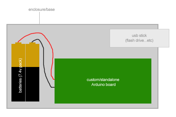

1.) when the user takes the prop and connects it to the PC.. I want the Arduino (to know the usb/flash drive has gotten power) and to make the prop do something (move, blink leds, make a sound)
2.) I am saying USB/Memory stick (flash drive, thumb drive.. whatever you want to call it) to separate it from anyone thinking about a USB port on the Arduino circuit end of things.
maybe this help illustrate the project better? (visually)
a box.. with standalone/powered Arduino circuit..
in same box/enclosure.... there is a USB stick/memory stick/flash drive/thumb drive/jump drive.. (whatever you fancy to call it)..
I am looking for an approach to tell when the usb drive is plugged into the computer.. (ie: I think it getting power should be enough to signal this)..
so I want the Arduino to 'check' for this.. when it happens.. (ie: that pin goes HI).. do something based on the code.

Decide what type of USB connector you want this contraption to present to the PC. Perhaps you will decide to present a USB A male connector, the same as a typical USB memory stick. (There are other options.)
Get a USB cable which has the required USB connector at one end, and a USB A female socket at the other end. If you're presenting a USB A male connector, then this will be a plain old USB A male-to-female extension cable.
Plug your USB flash drive into the relevent end of the cable. Attach the other end to your enclosure so it presents the right external interface. You now have an internal lead connecting to the flash drive. You are free to hack into this cable to expose the 5V and ground lines for your Arduino to sense. If you want to be slightly more elegant about it, instead of using an extension lead you'll use a lead which has a panel-mount socket; this would have exposed terminals at the back which you could connect to directly.
What's the problem?
to me your solution is saying to always have some 'pig tail' cable sticking out of the prop.. (not acceptable)..
I dont know what you mean by this: "Decide what type of USB connector you want this contraption to present to the PC"
I cant really 'pick/decide' anything.. (unless your suggesting make some 'go-between' board between the flash drive and the cable)?? which is silly, and way more work than would ever need to be done. the flash drive has a predetermined usb connector/end.. (that fits directly into a usb port on a PC)
the image explains it. thats whats inside the 'box' with a slot for the fllsh drive end to stick out
there is a 'slot' in the prop/project base that exposes the flash drive/memory stick so it can be connected to a computer.
thats just how it works/is.
so while you could use an extension cable to connect the prop/project to the PC.. there is no way to make any contact from the outside of the box (where the cable resides/connects to the flash drive).. to the inside of the box (where the Arduino resides)..
I just dont know how to explain it any clearer than that
