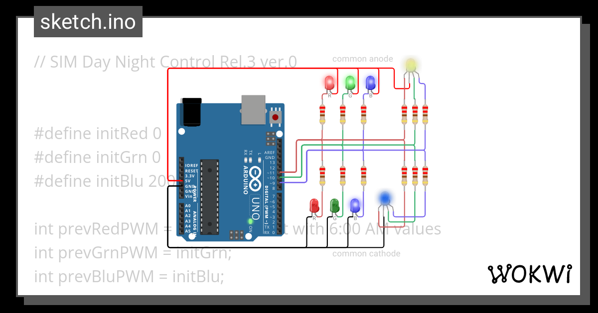

Your project in Wokwi simulation:
> **[Using analogWrite and getting strange initial results - Wokwi ESP32, STM32,...](https://wokwi.com/projects/398128680494393345)**
> Run IoT and embedded projects in your browser: ESP32, STM32, Arduino, Pi Pico, and more. No installation required!
Is it common anode or common cathode ?
What you describe might be a reset. How many of which leds are you driving and what power supply do you use ? How is the grounding ?
A reset can be recognized by adding a Serial.println() in setup():
```arduino
  Serial.println("The sketch has started");
But that only works if computer with the Serial Monitor is connected.
You could create a startup sequence.
```arduino
  Serial.print("Test blinks... ");
  for(int b=255; b>0; b/=2)
    analogWrite(RedOut, b);
    analogWrite(GrnOut, b);
    analogWrite(BluOut, b);
    delay(200);
    analogWrite(RedOut, 0);
    analogWrite(GrnOut, 0);
    analogWrite(BluOut, 0);
    delay(200);
  Serial.println("Done");

@Koepel The LEDs are on a 50’ strip of RGB LEDs. And are driven through 2N7000 MOSFETs. They and the Nano run off a 2A 12V bench power supply. The combination draws from 170mA to 700mA. Note that the majority of the current drawn (for the LEDs) is NOT supplied by the Nano; it’s supplied by the 2N7000s.
