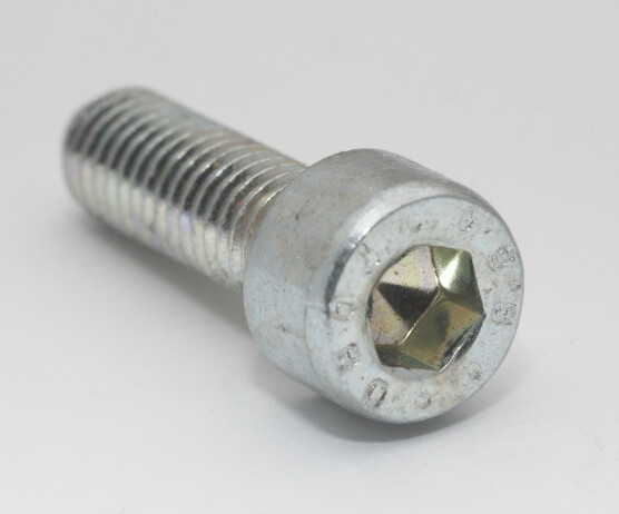

To give you an easy to understand analogon:
Trying to port assembler-code from a microcontroller of type Atmel328 (Arduino) to a microcontroller type Xtensa LX106 (ESP8266) is like trying to fasten such a screw
grafik
with this tool
grafik
Assembler-code is below the level of C++-coding.
Each microcontroller has its own "core" which is used to translate "high-level" commands like digitalWrite() if() etc. into that kind of assembler-code that suits to that exact type of microcontroller.
So a direct port of assembler-code is simply impossible.
