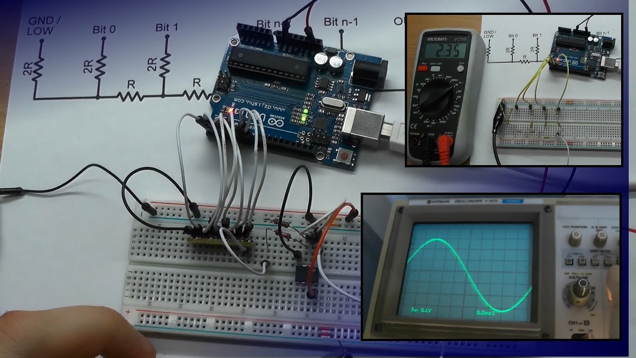

Hey,
look at this tutorial on youtube. He makes his own DAC using resistors and sends audio through it.
lookup his other project called "Arduino audio sampling tutorial (part 1)" as well.
Good luck.
Yes but because he doesn't know what he is doing it is a very poor DAC and so the results are much poorer than they otherwise could be.
