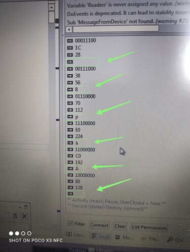

Watch the video I use the same code he works well on the serial port but when you add Bluetooth the problem appears
Ok, but the terminal window you posted contains some non printable chars (some "binary" bytes): I don't know what they are and from where you got them (you haven't specified their source), and that's not the intended Arduino output.
Print the "packet" received bytes in hex and compare them with what the source, for Arduino you can use:

Its source from visual basic 6 I moved the code to basic4android, the data is processed correctly like vb6, but the problem when it reached the Bluetooth module, I used another code the LED on and off, the same problem
                         This is b4a data
There is an empty byte in both programs, ASCII of char is not recognized because the keyboard languge has a specific char... Is this true????
Capkkjjture
I know VB6 but I know nothing about B4A, anyway the picture you posted here seems to me a multiple base dump, 4 lines for the each sent byte. The first line is binary, the second hex, the third octal, the last is just the ASCII character.
What you need to look at are just the first two (so forget the third and fourth lines of each block): the binary, because represents the desired led statuses, and the hexadecimal, because this is what you need to check with the code I suggested you before.
In this case, for example, if on Arduino Serial monitor you see the sequence given by the second line of each row (I assume the first 5 only, as the block is made of 5 bytes) is "1C 38 70 E0 C0" the data from the B4A code is correctly received. If not, you need to check what's going on and we can't do it for you.
Said that, if you want/need to debug using the Serial (pins D0, D1) you first of all need to use SoftwareSerial to connect the BT module to another pins pair, and not the default, and change your code accordingly.
If you don't know SoftwareSerial have a look HERE. Depending on how your B4A does with the BT port, it could solve your issue by avoiding communication conflicts.
If it doesn't solve your issue, please do what I asked you before: let the B4A program send just a few packets and track both the hex values sent (if possible put just the hex values on the debug B4A window you have shown us) and received (using the code to print received packet hex values).

it was solved in b4a using
GetByte ("ISO-8859-1")
rather than
GetByte ("UTF8")
but noticed something going on, the data is piling up(freezing). And after a moment, it's back
It there a bug in bluetooth? Is there anything to bypass this? At Command settings. or anything
