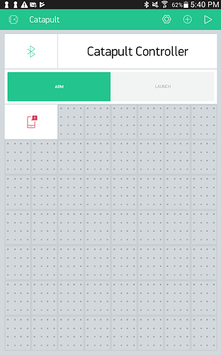

I am writing an Arduino program to control two servos on a catapult via Blynk using Bluetooth serial communication. I have two widgets on my Blynk application; the first widget consists of two buttons: 'Arm' which will lock the catapult arm into place and tension it and 'Launch' which will release the lock servo and release the tension from the catapult arm (which is assigned to virtual pin V0), as well as a second Bluetooth widget that will allow me to pair my Android device with an HC-05 Bluetooth Module. My hardware is already set up, so now I am just trying to figure things out on the software end. I uploaded my program to the Arduino and paired my Blynk application with the Bluetooth Module, and they were successfully paired (indicated by a blinking light every 2 seconds), but my Blynk button input to the Arduino was met with no response from the servos. I checked my jumper wire connections to and from the Bluetooth Module and they were all correct (VCC to 5V, GND to GND, RX to RX, and TX to TX), so unless I am supposed to connect the RX to TX and the TX to RX, I believe my problem lies within my program. Am I following the correct structure in my program to store button input or should the BLYNK_WRITE() code be placed inside my loop?

formoverfunction1738:
You are supposed to connect the RX to TX and the TX to RX. The reason is that "RX" stands for "receive" and "TX" stands for "transmit".
